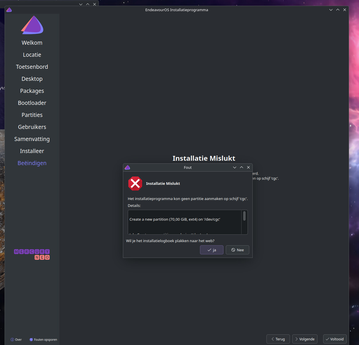

Endeavouros Mercury Neo 2025.03.19 installation failed
The Calamares install failed when i do the install
  • did an install of the Gnome desktop

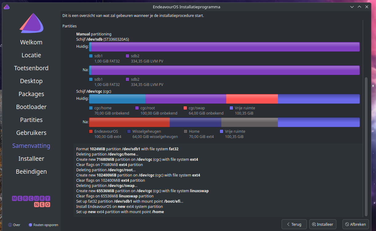

  • manual partitioning see screenshots
https://termbin.com/4opy
It looks like it failed to create the partition.

/dev/cgc should not been created here because
/dev/cgc/root (=100GiB), /dev/cgc/home (=70GiB) and /dev/cgc/swap already exist !
Oh,I just looked more closely. You trying to use LVM.
Calamares LVM support is not fully functional. You have to use some manual workarounds to get it to work.
what are the manual workarounds to do it working… ?
With previous version of Endeavouros it was working !
please tell me the manual workarounds.
Some of the potential workarounds are mentioned in this topic:
