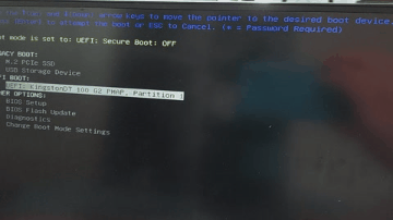

First driver I installed after OS installation was using installer here:
I’m not sure how that intel-driver ended up there
What option did you choose when starting the live USB? Free driver or non free (Nvidia).
Hmm. I’m not quite so sure whether it asked about drivers?
It does and it is very important. It looks like you loaded the free drivers when you installed and are now trying to install nvidia drivers on top of that.
Right here…
Now I understand what you mean. I just checked what happens when I boot from liveusb. For me the selection screen flashes so quickly that I missed this during installation. It’s definately less than 1 second.
Well it seems my installation was done using UEFI default I guess? Even if Nvidia is “selected” as default.
It is not. Yes you installed using the free drivers and are now using the integrated GPU on you CPU. This is why I said earlier on that “something” was missing. It doesn’t look like you have successfully loaded the nvidia drivers.
