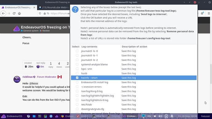

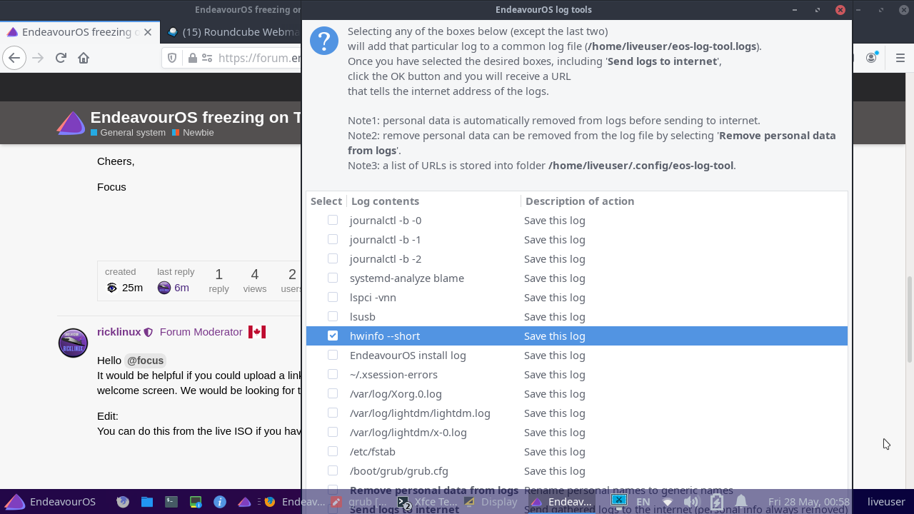

Hello @focus
It would be helpful if you could upload a link to the hardware using the log tools provided on the welcome screen. We would be looking for this one from the log tool. inxi -Fxxc0z
Edit:
You can do this from the live ISO if you have issues with the installed system.
Hello @ricklinux! Thanks for responding
I couldn’t find what you referred to specifically…
But, I think this will do the job… Yeah?
#################### hwinfo --short ########################
