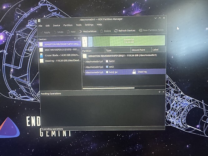

Positive. The USB is Cruzer Blade and the disk selected is KINGSTON, which has my 2 other partitions on it that I’m able to remove. I may have messed up my kali install earlier, that may be a possibility.
Can you share a screenshot?
I’m unable to send a screenshot or remote in due to lack of experience, so here’s a pic from my phone
I’m also unable to do anything when I select it on devices
Haha…partition manager is doing the same thing. It is mounting the lvm volume group.
Click on dead-vg on the left and delete that volume group.
Oh shit! That did it
