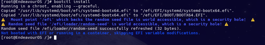

Ok, I’ve managed to chroot into my system, but I can’t reinstall systemd-boot. What am I missing here?
I don’t think you need to install bootctl. Maybe just try sudo reinstall-kernels while in arch-chroot.
Edit: Since there is a new kernel anyway maybe just run another update first and see in arch-chroot.
Yes, that’s correct. I reinstalled the kernel and it got EOS back to the boot menu.

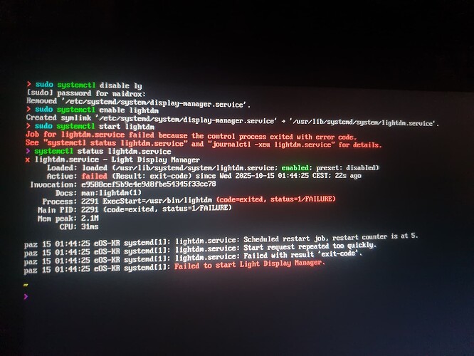

Have you tried lightdm?

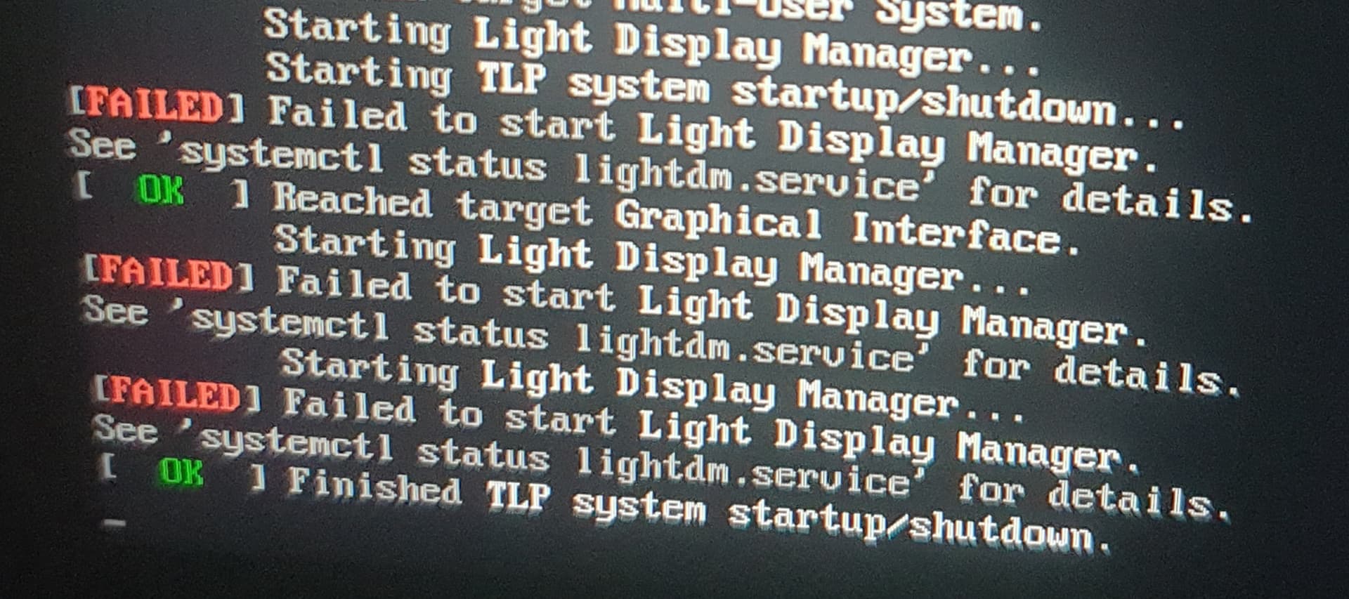

I’ve just tried it. It fails to start.
Did you enable and start the service?
systemctl enable lightdm.
systemctl start lightdm
Yes. Here’s what I get:
