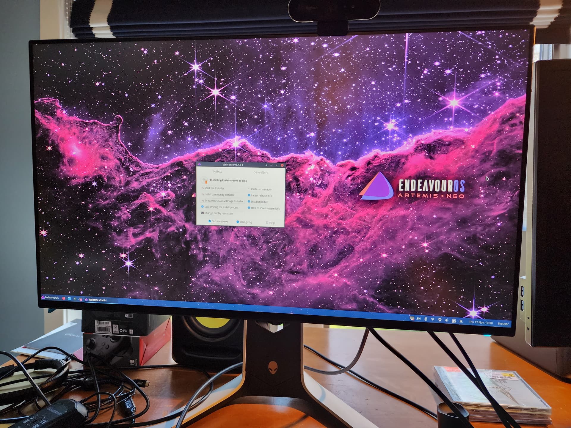

Edit: Oh my goodness, choosing the nomodeset option but removing all of the blacklisted modules works! X still throws an error, but then I’m in XFCE!
20221117_135845

Only the nomodeset with nothing blacklisted. X threw an error, only to load XFCE again. But this time, the installer actually loaded and let me install EndeavourOS!
