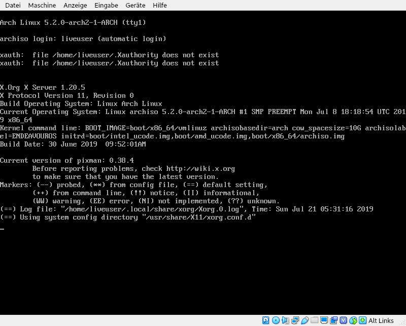

Endeavour OS Stable ISO does not boot with virtualbox
Hello, for my part no problem: download in direct link
MadMax, switch from VMSVGA to VBoxSVGA!
Thanks, that was the solution.:+1:
for virtualbox with 3d acceleration choose VBoxVGA as graphics controller to boot into liveenvironment :wink:
Bildschirmfoto%20vom%202019-07-21%2018-34-10
hello ,it’s VMSVGA and the 3D that bug and not VMSVGA alone
