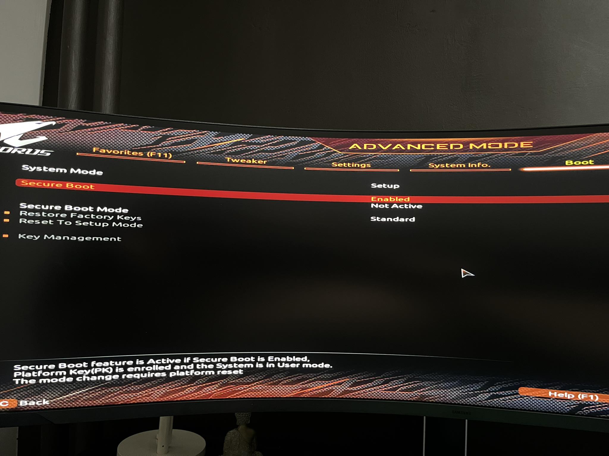

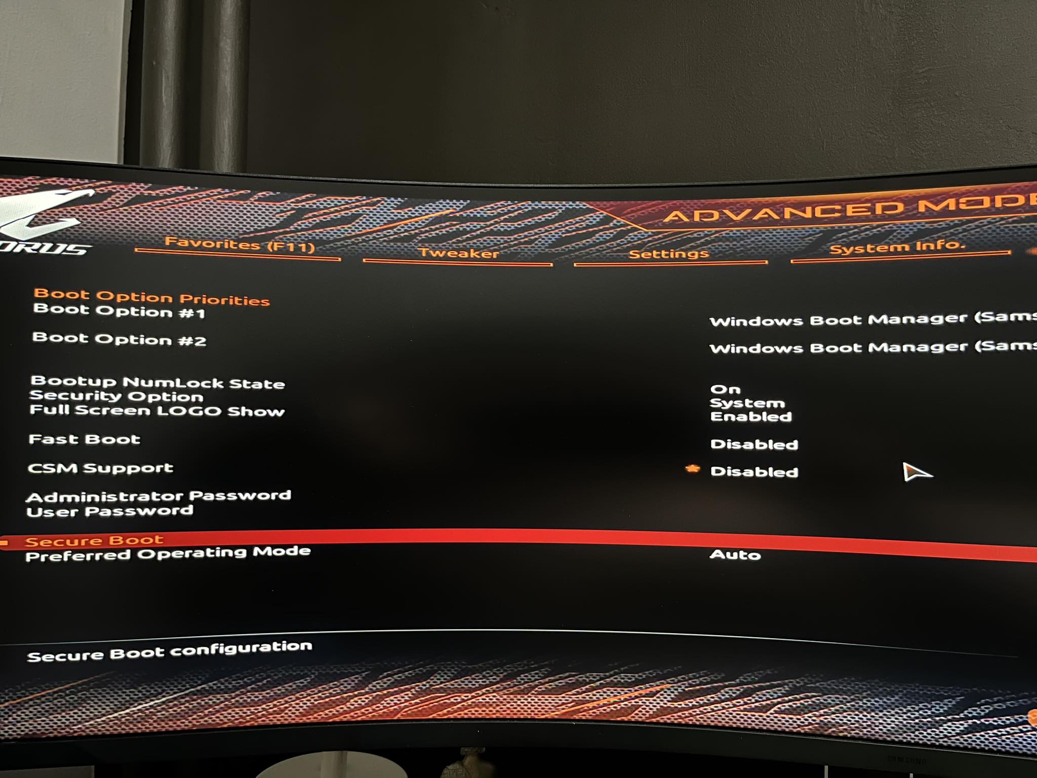

@thefrog I can’t find any option for ‘Smart Boot’ into my main machine.
When I go to Secure Boot I have these options:

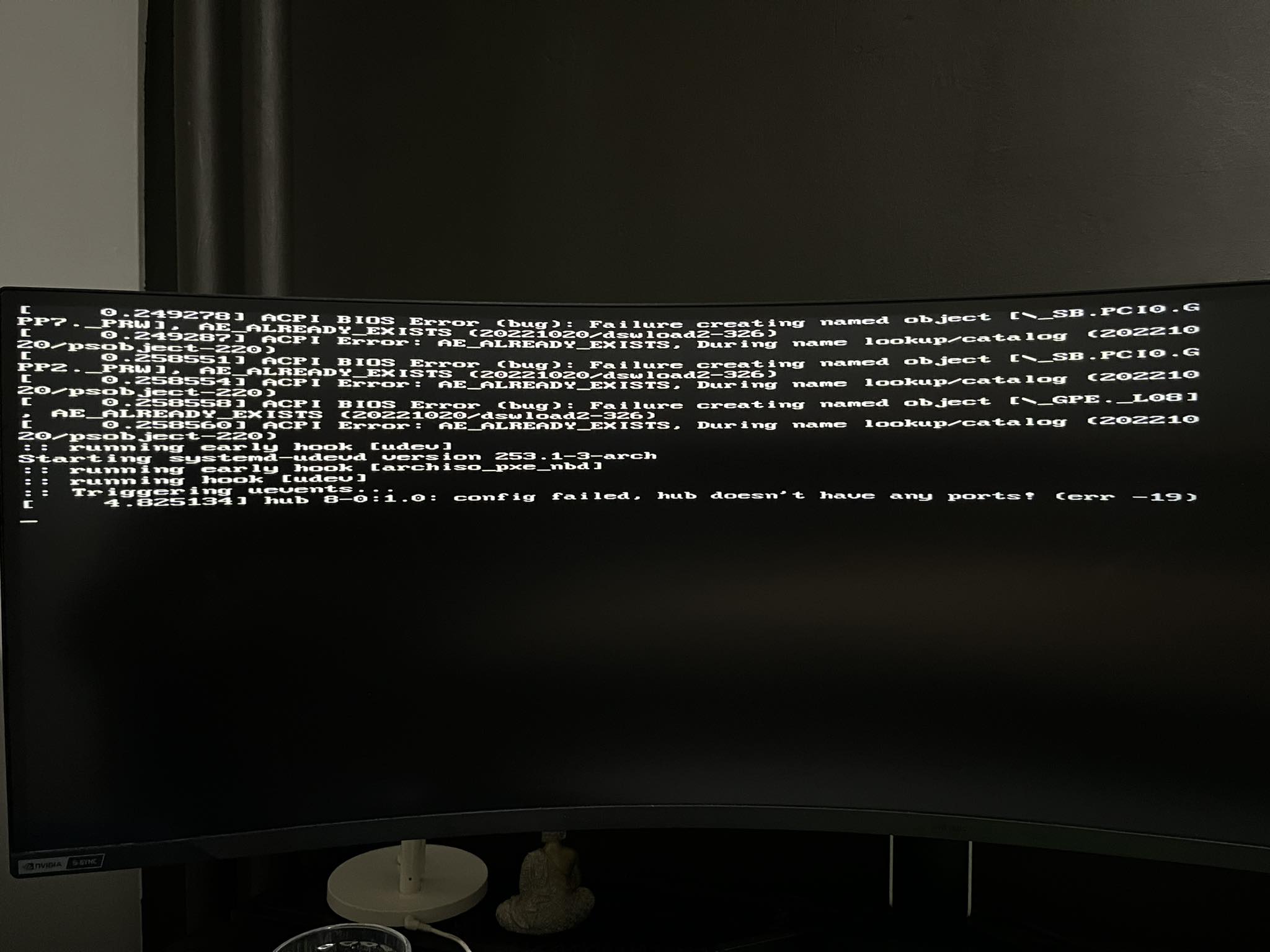

My idea was to try to do a clean re-install from the USB with the ISO installer while using my main machine ( I don’t really know if that would make any difference !? ).
I am getting the following error while trying to boot from the USB:

I actually meant secure its been so long since I have had to change it just didnt remember the actual name lol however secure boot does need to be disabled
Secure boot needs to be disabled.
Update:
I disable secure boot, but didn’t really had any impact.
