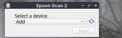

Embarrassing flatpak question (epsonscan2)
[drunkenvicar@endeavour ~]$ flatpak run net.epson.epsonscan2
QIBusPlatformInputContext: invalid portal bus.
QSocketNotifier: Can only be used with threads started with QThread
Gtk-Message: 19:52:07.488: Failed to load module “xapp-gtk3-module”
Gtk-Message: 19:52:07.489: Failed to load module “canberra-gtk-module”tart net.epson.epsonscan2
Problem: Wayland Endeavour Budgie can’t see Epson scanner, ever with a reboot.
can’t detect scanner even after reboots
Stupid Question #1": from the two “failed” warnings it sounds like a WAYLAND problem? Those are X11 packages in output, yes? I can’t shoehorn gtk murrine into Wayland can I?
The Internets say EpsonScan2 is Wayland-compatible. Por que?
Question #2: If the Internets above are true…..then what am I not considering?
Additional info: AUR package in X11 never saw sh** either, that’s why the Flatpak
BONUS WILD CARD: or is this a Budgie 10.10X issue and I should be taking it to Buddies git?
Thank you.

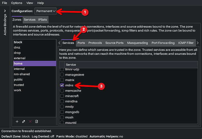

You’ll need to ensure the mdns service on your system is not blocked.
Or if you prefer the command line:
sudo firewall-cmd --zone=home --add-port 5353/udp --permanent
It’s used for things like printer/scanner/device discovery over the network.
I ran the command line with success but still the same. It worked OOTB for X11, not here.

I thought I’d mention it because it’s what resolved my discovery issues with my Brother multi-function :wink:
I neglected to check if it was a USB or network scanner! The above applies to a network scanner.
