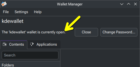

Might you try unlocking your wallet first, before starting Element. To do this, install kwalletmanager (if it’s not already), and start it. Unlock your wallet if it prompts you, otherwise, I expect it will tell you your wallet is currently open:
Now try starting Element.
That did it! I had kwalletmanager already installed but I’ve never used it before and I had to OK it using kwallet and once inside kwalletmanager it said my wallet was closed. So I opened it and then Element was able to open!
I had to sign into Element again so it seems something changed between kwallet and Element as I had not changed my password nor do I have auto-login.
Thank you for your help and reading the error messages I could not.
