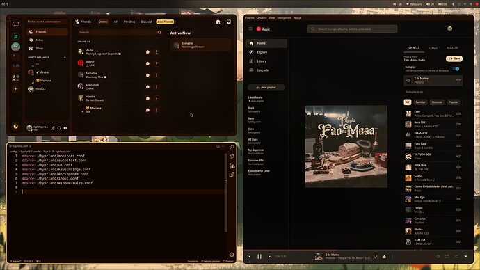

So i copied my .config to a pendrive then on my actual user copy and pasted those configs. After a reboot electron apps are working again. I think it’s probably a dconf setting making them crash.
The lesson i learned from this is never use Gnome again . Always breaks some stupid thing because of theming. I will just go back at using sddm as my login screen and only use gnome apps but not gnome itself.
Proof it’s working XD
