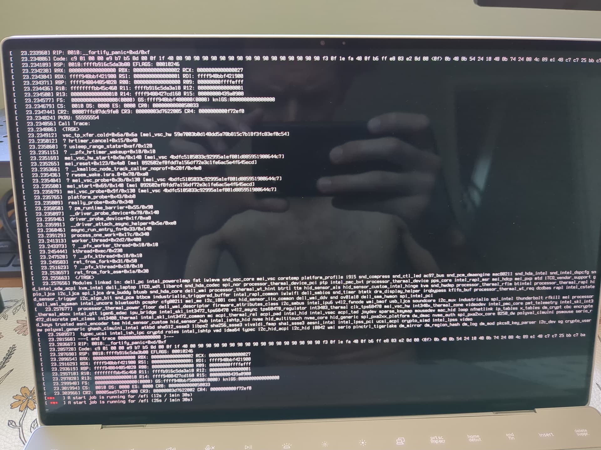

Efi fails to mount after upgrade
It depends on what hardware you have installed. I am using about ~100MB per kernel.
If you have nvidia drivers it will explode in size.
Ok, I reinstalled the kernels and then rebooted, but the same issue occurred (tried booting both standard kernel and LTS):
The size of my EFI partition is now approximately 282mbs, not sure if that’s a substantial difference?
I’m not sure, but there may have been some issue in the reinstall (potential issues at the end, and what is hostonly mode for dracut?):

My unfounded intuition is that container mode would be like a VM? (chroot may qualify?)
However, that fatal library error is something…dunno what.
That all looks normal to me. Those errors/messages are all caused by running in a chroot and are non-fatal.
Can you share the output of pacman -Q | grep -E "dracut|mkinitcpio|kernel|grub" from the chroot?
For sure, I checked that before posting as I noticed it on one of your attempts to help someone else. Here is the output:
[root@EndeavourOS /]# pacman -Q | grep -E "dracut|mkinitcpio|kernel|grub"
dracut 107-1
kernel-install-for-dracut 1.11-1
Could it be an issue with vfat module needing to be loaded early?
I would think if that was needed everyone would be having this failure.
Like so: :crossed_fingers:?
I got nothing…other than suggesting a full reinstall (or it’s equivalent, via pacman recursively reinstalling the installed packages).
If it’s an EFI problem, that won’t fix it, if it’s a library problem it probably will.
Anyone else?
Can you boot the fallback entries?
No, I tried both fallback entries the last time (and previously). They give the same results (as far as I can tell)
Would recursively reinstalling the packages with pacman via chroot allow me to keep all of my files/configs in place? And might the issue still persist?
It should keep your configs in place but I am doubtful it will help in this particular case. You will also need to be careful to do it in a way that doesn’t cause your dependencies to be marked as explicitly installed.
Right, that makes total sense. If there’s anything else I can try before a full reinstall, I’m all ears. But if that’s what’s required then so be it. Thank you everyone for your help !
Try downgrading dracut
BTW…I don’t think you need to reinstall here. I am sure this is solvable.
Not sure if this would help but before a reinstall I would try to rebuild the whole ESP from scratch.
Reformat. Chroot. Change the UUID in /etc/fstab. Mount /efi and rebuild the kernels. May help.
I think there are simpler things we can try first.
Ok will do! I just needed to run out to a meeting so will try when I’m back in an hour
