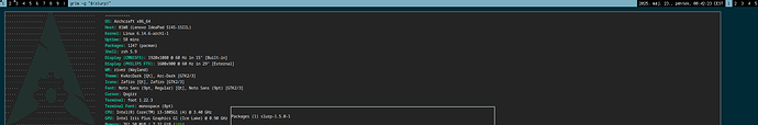

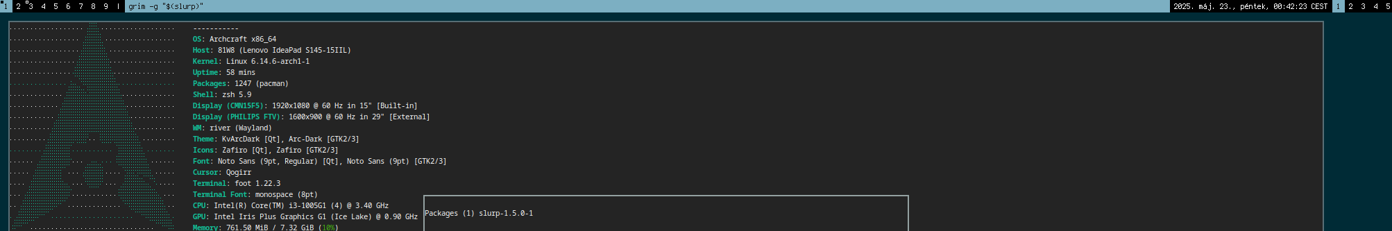

Out of curiosity I looked into river.
yay -S river river-creek foot
cp /usr/share/river/example/init ~/.config/river/
added to init
riverctl keyboard-layout hu
riverctl spawn "( while date; do sleep 60; done ) | creek -fn Terminus:size=12 -hg 18 -nf 0xffffff -nb 0x000000"
My first steps
