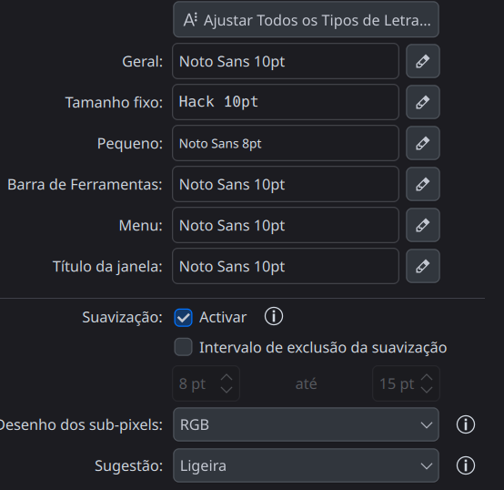

It seems a screen-scaling related problem to me. Did you change the default font?
