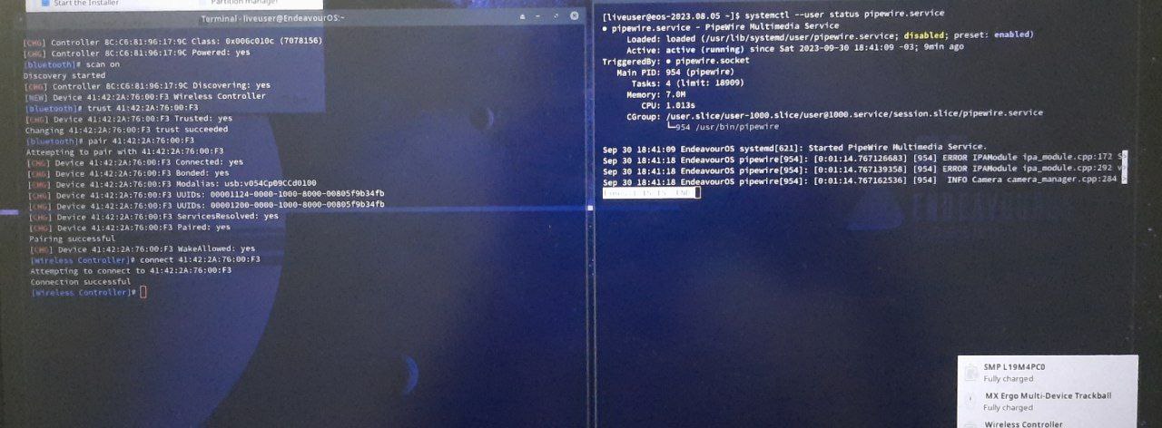

  • I’ve tried both the plasma bluetooth panel and bluetoothctl
  • I’ve tried resetting the controller by pushing the hidden reset button for five/ten seconds
  • The controller does work, it pairs fine with my phone
  • The Bluetooth on the computer works, it connects to my Bluetooth headphones (though now it also has some issues with audio dropping every few seconds)
  • Yes, I’ve read the Archwiki on Bluetooth devices (and followed this thread https://bbs.archlinux.org/viewtopic.php?id=270465)
  • Yes, I’ve updated the system in the last 2 day
  • Yes, I’ve looked many times at the bluetooth and pipewire process to see they are running
  • I’ve tried installing the bluez-utils-compat and bluez-plugins-ps3 packages

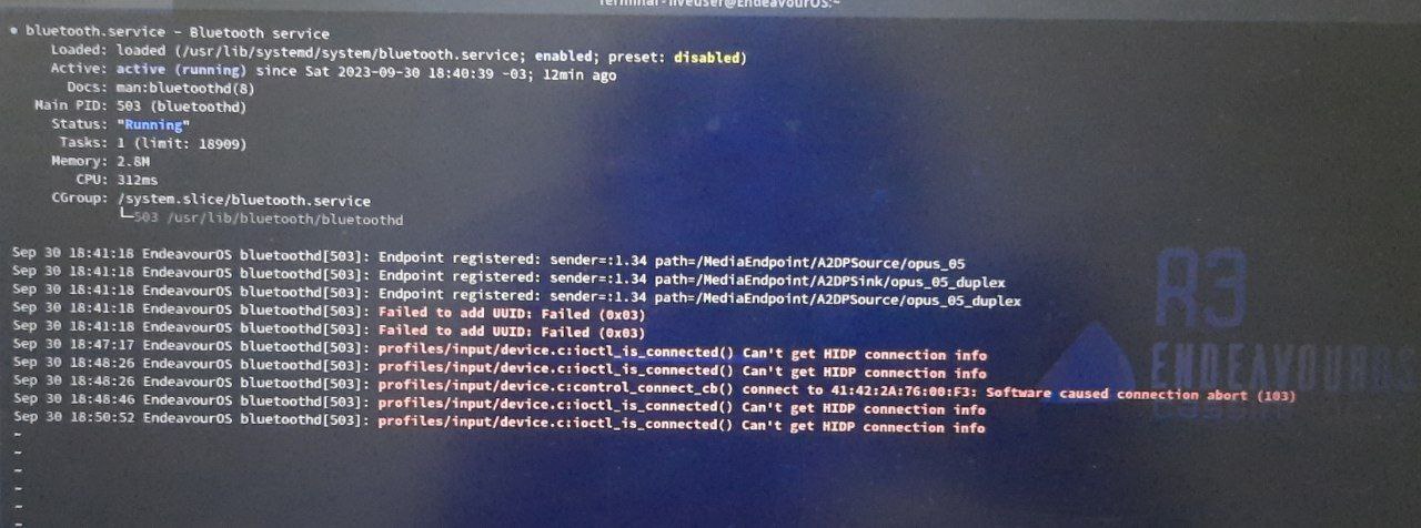

Some of the information I could get
In the bluetooth process there is this error entry
set 03 11:35:59 woods bluetoothd[21431]: src/service.c:service_probe() input-hid profile probe failed for 41:42:2A:76:00:F3
set 03 11:37:00 woods bluetoothd[21431]: src/service.c:service_probe() input-hid profile probe failed for 41:42:2A:76:00:F3

Some more error from bluetoothd when trying to connect if it means anything
set 03 15:16:50 woods bluetoothd[10005]: src/device.c:search_cb() 41:42:2A:76:00:F3: error updating services: Host is down (112)
set 03 15:17:07 woods bluetoothd[10005]: src/device.c:search_cb() 41:42:2A:76:00:F3: error updating services: Input/output error (5)
Btw I’ve said it before, but just to put more emphasis on that so maybe it can narrow down the issue or something.
I can still connect my bluetooth headphones to the computer as normal, but the audio will keep dropping every few seconds. Behaviour that, again, wasn’t happening before. I tested with two pairs, and both are acting the same, so still seems to be a problem on the computer side.
Another update, apparently from the live USB environment (on the latest ISO of writing) the controller connects perfectly fine.
Does the live environment use pipewire? Ok, it does
some pictures of connecting from the live environment
