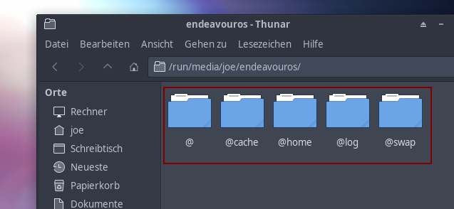

just tried to replicate… but no issue installing 2 instances with BTRFS both working fine…
IT can make sense to have different OS installed in case setups are very different or specialized… i have some in use too …
but thats the subvolumes of the BTRFS setup nothing wrong with it just reread your text and find out that you may only misinterpret?
but it should look like this:
Thank you very much. May be haven’t understand the sub-volumes :wink:
