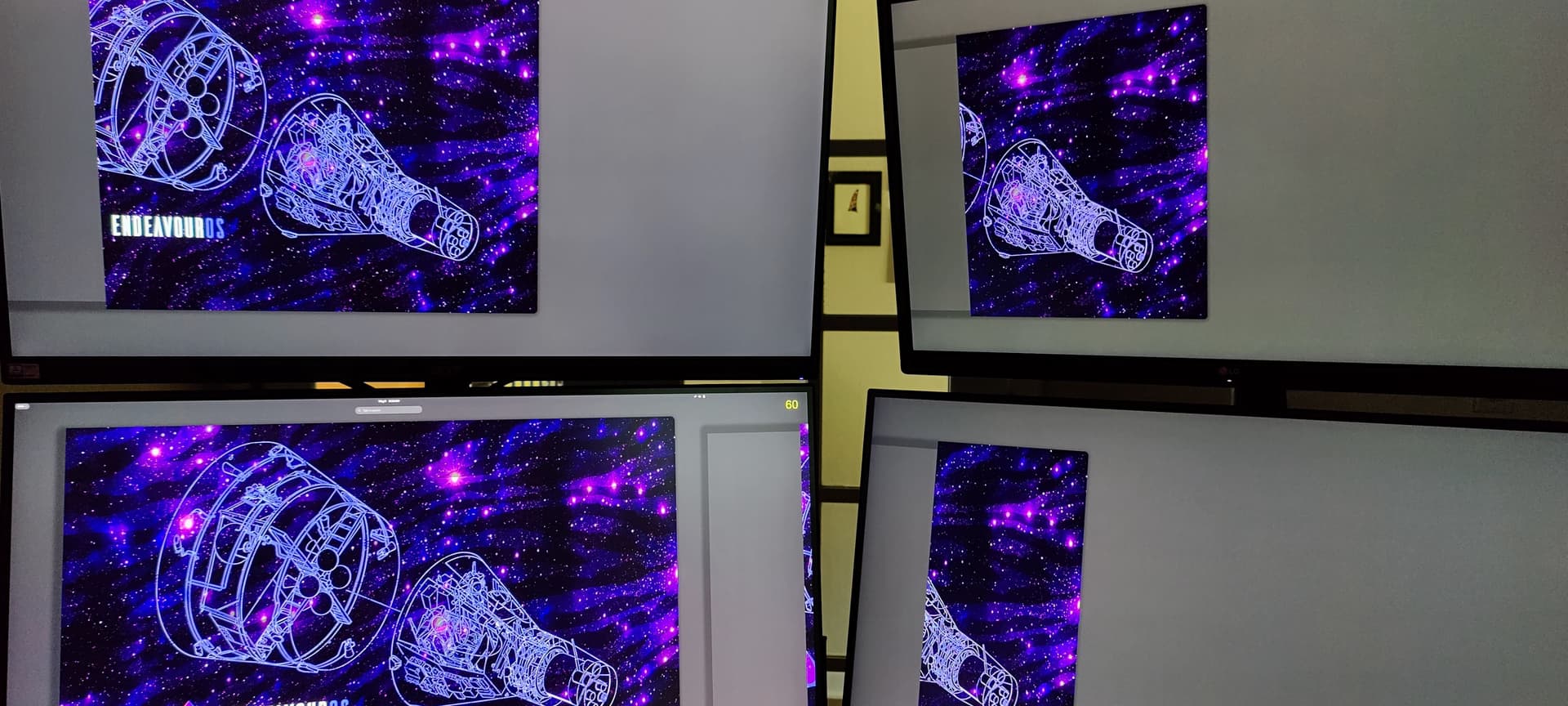

- AMD RX580 driving 4x displays @ 4k

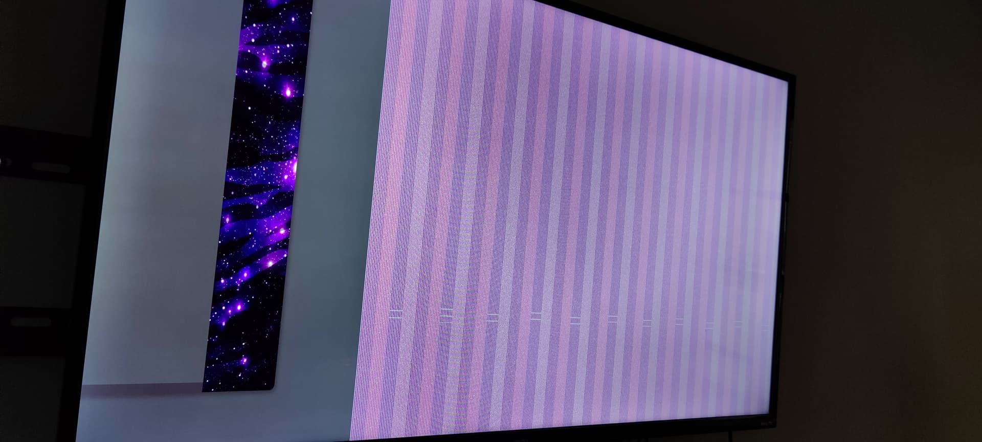

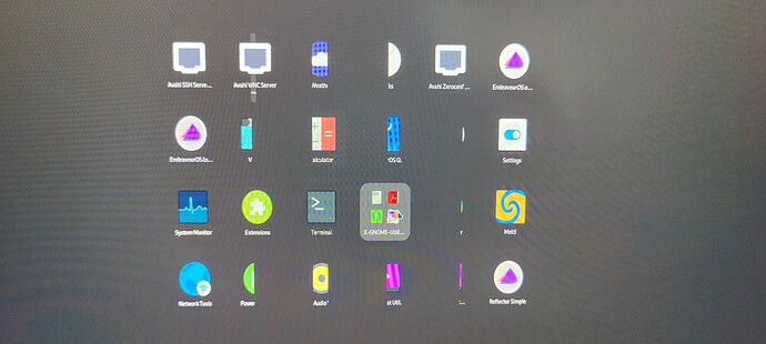

During the install process, sitting at the EndeavourOS logon screen, and post-logon there is severe display corruption. I was able complete the installation via the fallback/NoModeSet menu option - no display corruption in this configuration.

An update: Blacklisting nvidia didn’t do anything and I don’t think the nVidia is the problem.
The display corruption happens when the RX570 and the AMD iGPU are active at the same time. The problem disappears immediately when I unplug the HDMI cable from the motherboard. I don’t even need to reboot.
Not sure where to go from here but I can’t be the only one with this configuration… I’ll keep searching.
