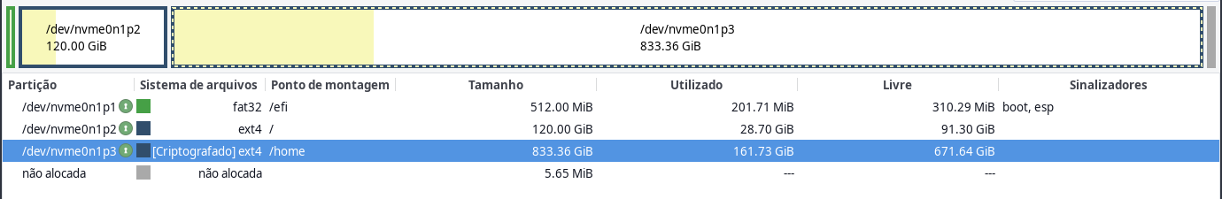

I have EOS installed in a nvme drive, want to create a partition and install windows besides it. I’ve read it’s dangerous and can corrupt linux. How can I do it in a safe way?
❯ **efibootmgr**
BootCurrent: 0000
Timeout: 0 seconds
BootOrder: 0000,0001,0002,0003,0004
Boot0000* Linux Boot Manager	HD(1,GPT,1bb85b05-62c4-4a49-b97b-4020f06153e8,0x800,0x100000)/\EFI\SYSTEMD\SYSTEMD-BOOTX64.EFI
Boot0001* UEFI OS	HD(1,GPT,1bb85b05-62c4-4a49-b97b-4020f06153e8,0x800,0x100000)/\EFI\BOOT\BOOTX64.EFI0000424f
Boot0002* UEFI:CD/DVD Drive	BBS(129,,0x0)
Boot0003* UEFI:Removable Device	BBS(130,,0x0)
Boot0004* UEFI:Network Device	BBS(131,,0x0)
Model: KINGSTON SKC3000S1024G (nvme)
Disk /dev/nvme0n1: 1024GB
Sector size (logical/physical): 512B/512B
Partition table: gpt
Disk options:
N       Start      End        Size         File system  Name  Options
 1      1049kB  538MB   537MB    fat32                         boot, esp
 2      538MB   129GB   129GB    ext4
 3      129GB   1024GB  895GB
gparted screenshot

  1. Shrink the partition of your current system.
  2. Leave the space you want to use for Windows unformatted/unllocated.
  3. Remove the boot,esp flag from your current system’s EFI partition.This will make Windows installer not recognize it as an EFI partition. It will create a new for its own boot manager.
  4. Start the Windows installer and let it install on the unformatted/unallocated space.
As I said, I have done it in the past but I don’t know if this will work now.
If you want to try this, you have to make a good backup of all your personal data. If something goes wrong and your Linux system is damaged you can always reinstall and with a little work get it back and running. But if you loose your data there is no getting back.
Also, make a live usb from the iso of your current Linux system to have as a safety net.
