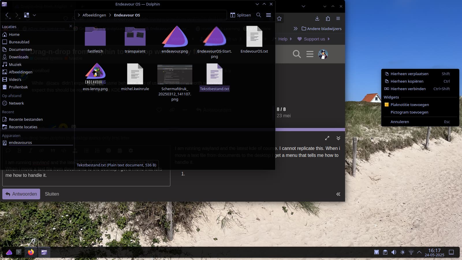

I am running wayland and the latest kde of course. I cannot replicate this. When i move a text file from documents to the desktop i get a menu that tells me how to handle it.
Same here, fully updated Plasma in a Wayland session.
