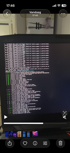

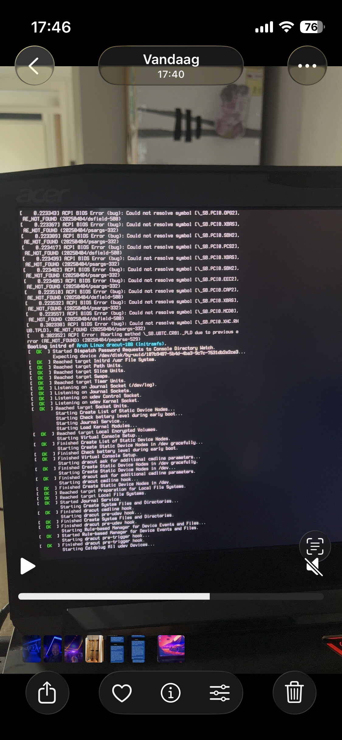

Dracut shows Arch linux during boot
Hi all,
Maybe a stupid question. I have a second gaming notebook with minimal installs for my wife/kids. Lutris/steam/pinta and osb studios are installed and some games. I keep the notebook updated with “yay -Syu”. Now today i noticed dracut does not show the endeavour os message during boot but it showed arch linux. My other 2 notebooks are showing the information correctly but this notebook it does not. What can the issue be ?
