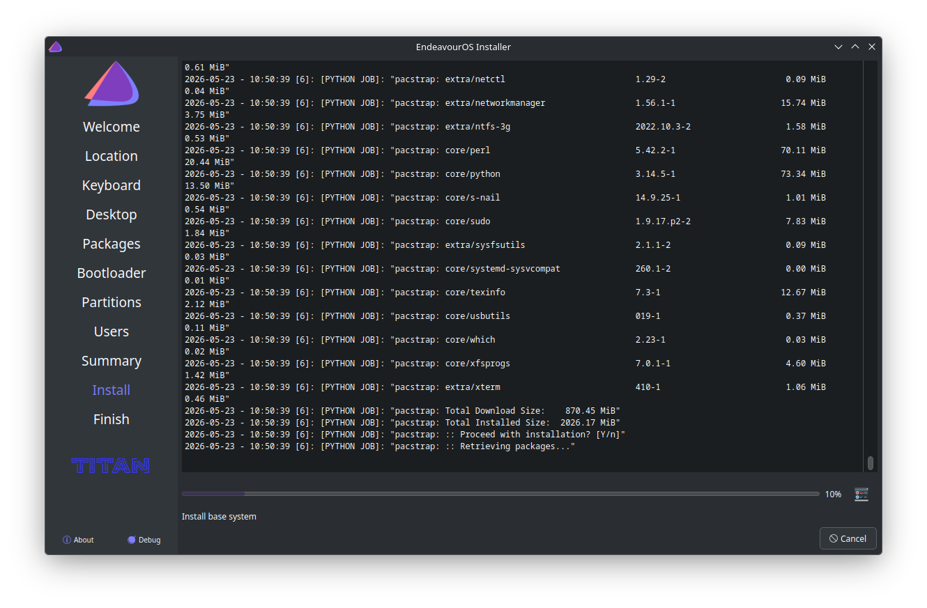

Twice during the online installation (of Titan), at 11% and 36%, the system is downloading files. To the user, the installation appears to be stuck or halted, because there are no indicators of the download process, or sub-process. Not everybody clicks on the terminal icon.
There needs to be some sort of assurance, that the process actually moving forward.
I think this is a Calamares limitation; not sure if it’s a “bug”, or a “feature”. I’ve seen this exact same thing on CachyOS and Manjaro, as well as other non-Arch installs I’ve done in the past. I’ve always changed the view to show the live installation log instead of the various slideshows.
This will happen during an offline install, as well.
Totally agree with @ajgringo619 on this I have installed quite a number of distros that where using calamares , and they all showed the same behaviour.

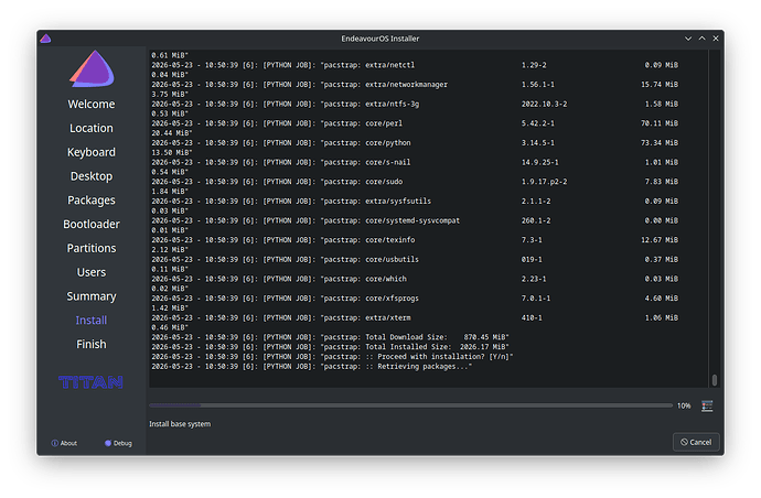

I has been a while since I used Calamares. If I remember correctly, in the bottom right corner of window, I believe horizontal to the Progress bar is an obscure button that will bring up a console window with the progress of the install.
Pudge
EDIT:
It’s the little box next to 10% in the above screenshot.
Pressing this will bring up a terminal window which will display every command as it is executed.
That is all Calamares will give you. Feature requests should be directed to the Calamares devs.

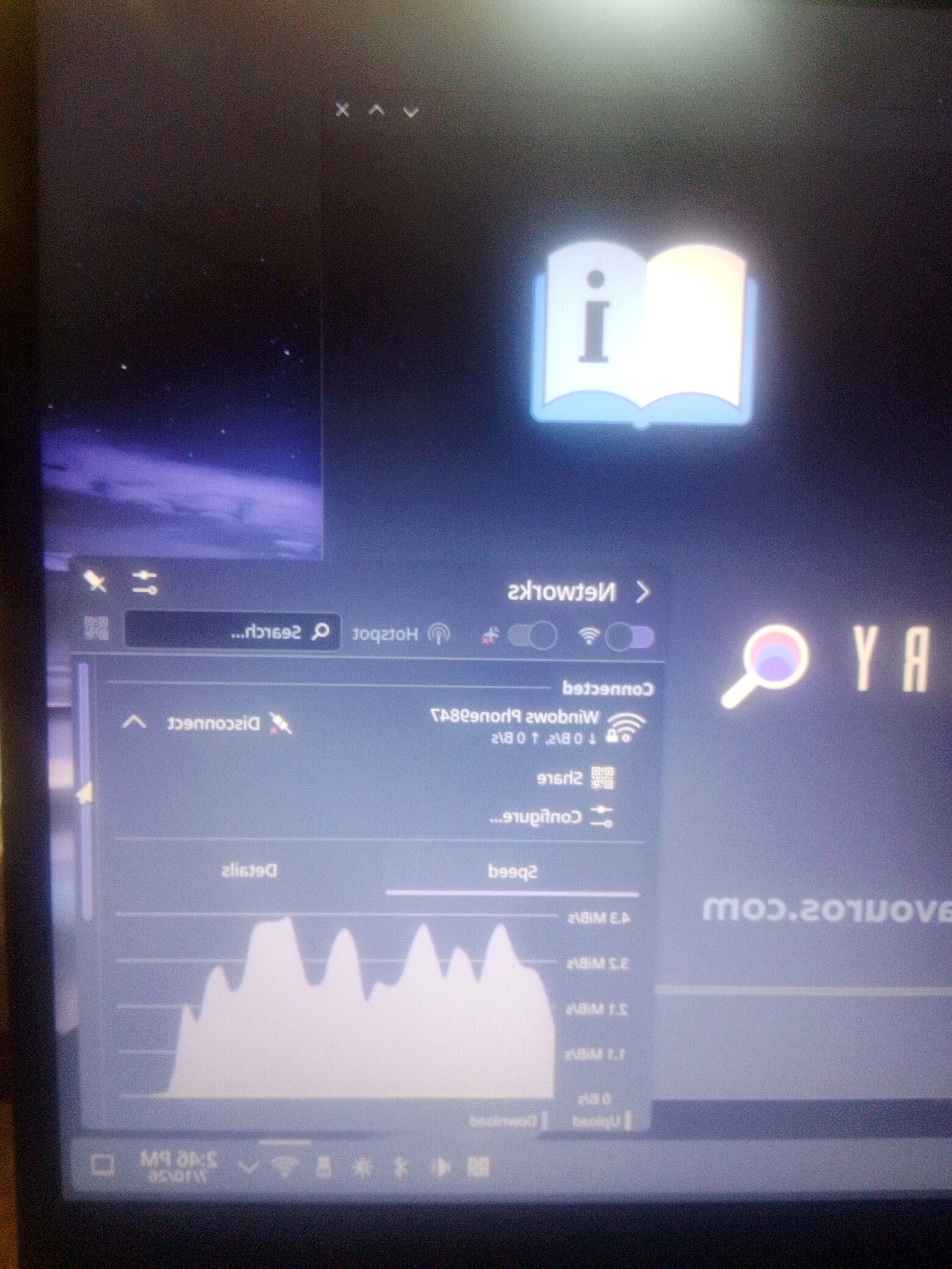

Networks in taskbar, expand current connection, make sticky flyout. All onboard but hidden.
