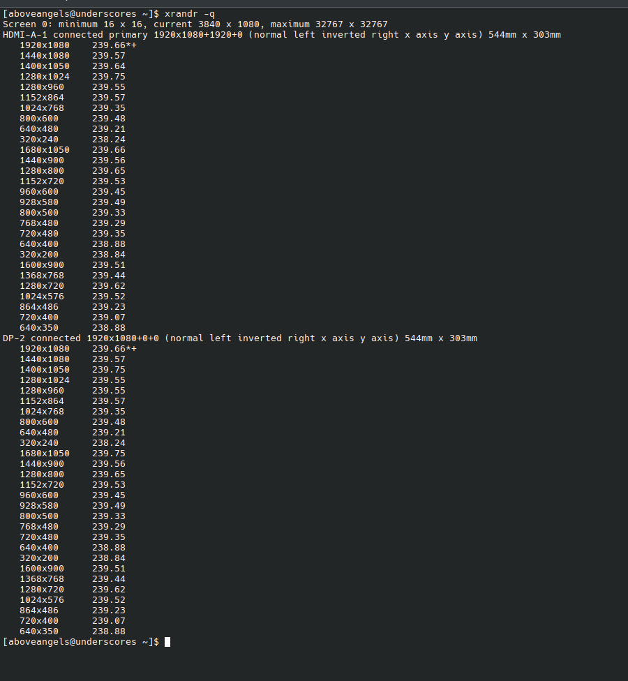

If that is not the case and what rick suggests doesn’t work, run the following to get a list of the monitor modes and what they are set to and post the results:
xrandr -q

I tried both solutions and nothing seemed to work, lowering the refresh rate didnt work, however when i changed my monitors resolution to 1680 x 1050 it seems to look perfectly normal.
I also think Wayland may not support 240Hz well. But that’s just an assumption. But i do agree with you DP 1.4 spec is much better and cables do make a difference. Some cables are just not up to spec.
I’ll try to get a better dp cable and see if that works. Besides that, are there any other solutions?
ok nvm when i first start up my desktop on the bottom theres this thing that says like “desktop session” i just changed it to x11 and it looks perfectly normal…weird lol
