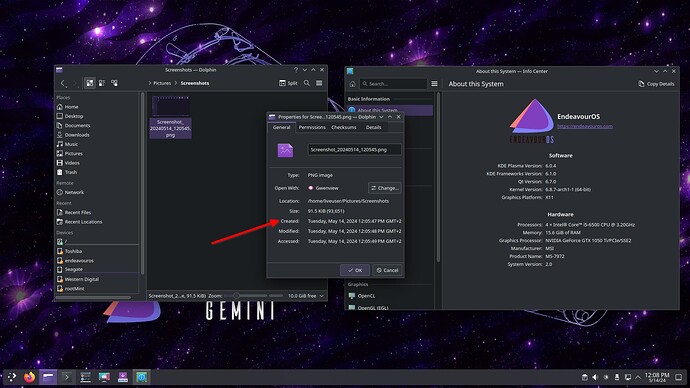

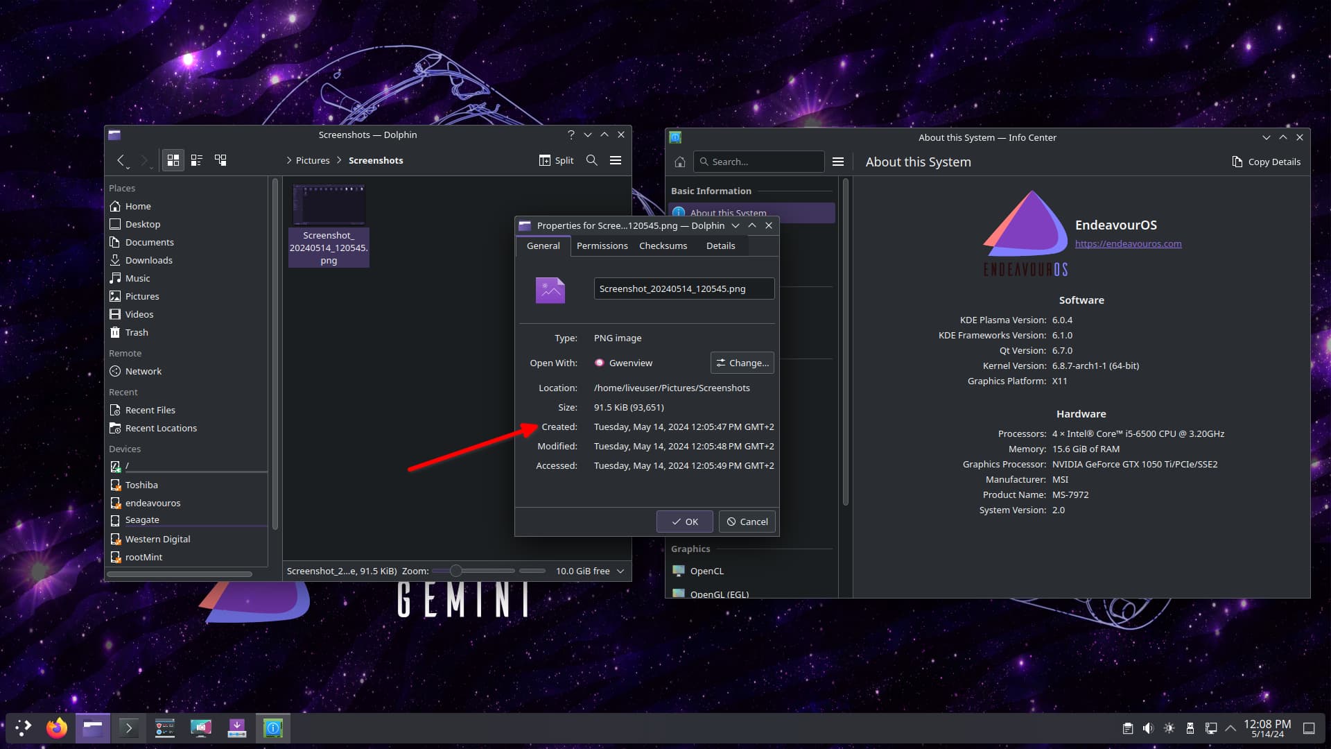

Recently I noticed that Dolphin file manager does not show any of the file’s creation time anymore (it was showing this info, few days ago…). Be it a directory or a file. The files are under my /home folder of course. Checked this on multiple installs over my computers, everywhere its the same symptom.
If I stat a specific file from the terminal, it gives back the creation time.
Checked now with a live enviroment, and Dolphin shows the file creation time.
What happened?
Screenshots for clarification.
Live enviroment
Actual install
I was thinking maybe its wayland vs x11, but then I tried to swith, and its not it.
I noticed that Live has KDE Framework 6.1, while my actual install is already at 6.2. Could it be it?
Dolphin’s version is the same on my installed sys and on live (24.02.2)

Thanks, I already did those, but its not that unfortunately, plus it is only affecting the view itself, it has no relation to the actual properties window. As you can see, in the properties window (and consequently nowhere else), Dolphin doesn’t show creation date by its nature at the moment so its something oddish happening under the hood.
Also I’ve done a Dolphin setting reset to factory defaults. It’s an untouched file explorer now. Out of the box, it works on live, but not on my actual install, and I noticed that frameworks was updated yesterday… Maybe its that idk, I’m gonna try to downgrade it (Edit2: unable to downgrade it :sob: )

Ok, just did a clean offline install from the live iso into a virtualbox, which has the 6.1 kde framework. After I installed, Dolphin shows every data. After I performed the update, it obviously updated itself to 6.2 kde framework, and then Dolphin didn’t show any creation date after that.
