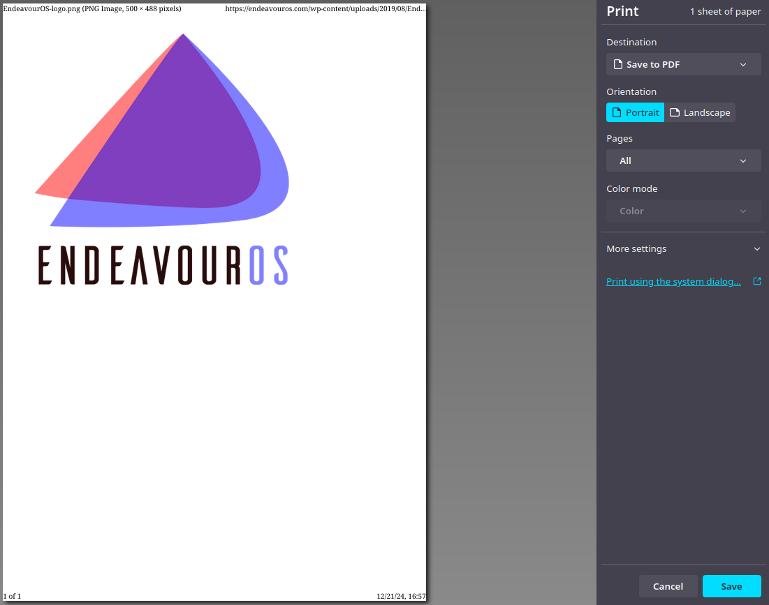

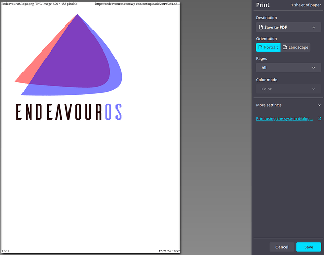

Thanks friend. I turned on the printer, put in the 2 color cartridges, connected the USB to my PC, installed the driver and ran several commands because I don’t know which one is correct:
sudo lpadmin -p G6000 -m canong6000.ppd -v cnijbe2://Canon/?port=usb&serial=6DF882 -E
And
sudo lpadmin -p G6000 -m canong6000.ppd -v "cnijbe2://Canon/?port=usb&serial=6DF882" -E
I got:
sudo: lpadmin: command not found
Then I pressed ctrl+p and this screen appears, but the printer does not appear in the drop-down menu.
