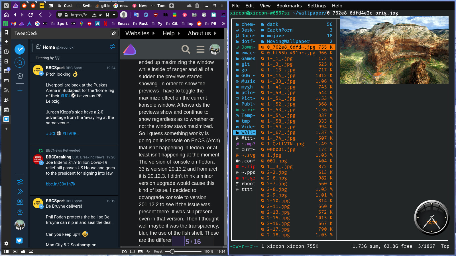

Does anyone know why using ueberzug + ranger in KDE's Konsole does not work on EnOS, but does on Fedora?
So, I’ve got two computers a laptop running endeavourOS and a desktop running fedora. Installing ueberzug through pip and ranger through the official repos and setting the appropriate settings in ranger’s config file shows the image previews in ranger on my desktop running fedora. However installing ueberzug through either the community repo or through pip on arch and using the same configuration settings results in nothing being shown on endeavourOS (Arch). It works properly on the same laptop when using say xTerm just not in konsole. Can it be that konsole was compiled differently in the arch repos than in fedora? Missing support for whatever is responsible for handling image supports in terminal emulators.

Some how I stumbled across what was happening right after I posted. I ended up maximizing the window while inside of ranger and all of a sudden the previews started showing. In order to show the previews I have to toggle the maximize effect on the current konsole window. Afterwards the previews show and continue to show regardless as to whether or not the window stays maximized. So I guess something wonky is going on in konsole on EnOS (Arch) that isn’t happening in fedora, or at least isn’t happening at the moment. The version of konsole on Fedora 33 is version 20.13.2 and from arch it is 20.12.3. I didn’t think a minor version upgrade would cause this kind of issue. I decided to downgrade konsole to version 201.12.2 to see if the issue was present there. It was still present even in that version. Then I thought well maybe it was the transparency, blur, the use of the fish shell. These are the differences between my konsole setup on EnOS vs on fedora. I tried using bash and changing the profile back to a standard solid color background. Unfortunately, all to no avail. I’m stumped on the issue. After this I decided to move my current settings for konsole and use the completely default settings, but the issue still persists. For some reason I have to change the size of the terminal in order to get the previews to show up. I don’t even know where to file a bug report. Currently my new theory is that the issue is not with arch, fedora, or konsole, but with ranger itself not setting the proper values for length, width, and the rest. Next I’m gonna see if I can use ueberzug directly to show an image, and then see if the issue still persist.

It woks for me. I don’t know if you saw the reply I wrote to myself. The issue presently is not that it doesn’t show previews at all, but that I have to maximize and unmaximize the terminal in order to show them. The issue is only present in kde’s terminal emulator konsole. I don’t have the problem in xterm. The thing is, the issue is not present in konsole on fedora.
For me, this doesn’t occur. It works regardless of the maximized state of the window. It even works in a split terminal.
And that is why I am stumped on the issue here. I even tried resetting the konsole profile to default and deleting the config files.

Sorry for taking a minute. I know that it works properly with a new user. That means it is definitely something wrong in the home folder. Also I didn’t have anything extra in my rc.conf. One thing I didn’t try was deleting my ranger config and starting over. That might work.
Deleting the ranger config and just recreating rc.conf didn’t work. I think has to be something with my konsole profile or maybe my font settings.
I think I made it worse somehow. xTerm isn’t working properly anymore either. I’ll try a full reboot and see how that goes.

In the end, I’ve decided to just carefully move things over to a new user.
It turns out the issue was caused by the fish shell. I think I’ll switch back to zsh and see how that goes.
