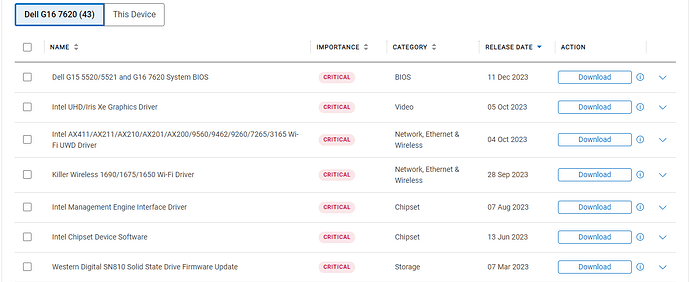

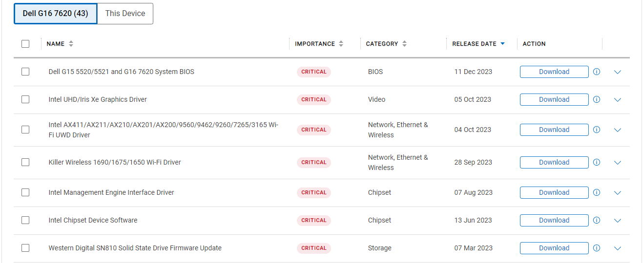

Issue initially presented as only being the inability to draw more than 45W of power. A brief summary of previous troubleshooting for that:
  • Installed and tested every major version of nvidia-dkms, and nvidia-open-dkms, respectively.
  • Installed and tested every major kernel release in conjunction with the above, no resolution.
  • Installed Windows. (Eewww.) Confirmed issue is present on Windows.
  • Dell provided a motherboard replacement. Temporarily resolved issue.
  • Dell provided a battery replacement. Resolved issue on Windows, but introduced overheating issue.
  • Dell provided a heatsink replacement. Resolved issue on Windows. Initially also resolved on Linux… sort of.

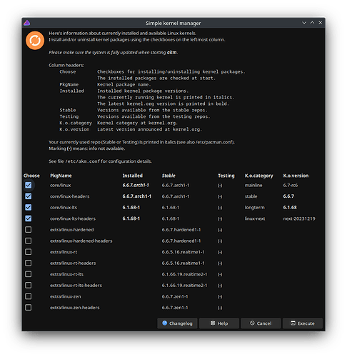

  • Reinstalled and tested the following kernel/nvidia driver combinations:
  1. 6.1.67.1-lts/nvidia-dkms 545.29.06 *** Previously working configuration
  2. 6.6.6/nvidia-dkms 545.29.06
  3. 6.6.7/nvidia-dkms 545.29.06
  4. 6.6.7/nvidia-dkms 525.85.05
  5. 6.6.6/nvidia-dkms 525.85.05
  6. 6.1.67.1-lts/nvidia-dkms 525.85.05
  7. 6.3.67.1-lts/nouveau
    Kernels installed via AKM. Nvidia packages via:

  • Upgraded BIOS from 1.20.0 to 1.21.0, no resolution.
  • Downgraded BIOS from 1.21.0 to 1.14.0, no resolution. Fewer issues in journal though.

Have you tried the zen kernel?
Until you said that, no. I had never before used it and completely forgot it existed. So naturally I immediately installed it to test it out.
I am both elated and infuriated to report that after 6 hours troubleshooting this tonight, and over 200 troubleshooting the PC over the last two months, my system now appears to be just working. No rebooting three times to get everything functional. Nvidia has stably worked every single time I’ve rebooted (six times now) without reverting back to being limited to 45W. My DP monitor has worked every single time. My Wifi is even faster.

Glad you got this sorted. Thank you for providing the detailed information. It is what allowed me to instruct you to try that kernel as your information shows you had only tried LTS and driver variations. As an aside it is always good practice to keep more than one kernel installed in case of a regression that may cause an issue. Personally I keep three. Linux, LTS, and ZEN. Your hardware is not that old and does not really need the LTS which is primarily geared toward older hardware. Enjoy your time here! lastly, don’t wait so long next time to ask for help. There are plenty of helpful folks around here.
DO a hard reboot after kernel installs. And whatever follow up procedure is necessary for how you are booting be it systemd or grub.
In the way of FIY, the current linux(-zen) kernel is 6.6.7.
Perhaps your mirror(s) is (are) out of sync?
You could update your mirrors and update your system.
Understood. Re-ran sudo reinstall-kernels and shutdown -h now, same issue still presenting. There was a rather lengthy traceback for something failing, but I didn’t grab my camera in time to document it, so I’ll do that on the next go around.
I didn’t realise that, thank you for pointing it out! I re-ran mirror syncing from the welcome app to make sure I didn’t mess a command, but I don’t seem to have anything I can update still – any chance I did something wrong?

nods ~ Got it! Still nothing, sadly :(. AKM also doesn’t list the zen kernel with 6.6.7. Do you think it’s worth a full wipe at this stage? I’m hesitant to do it again given it’d be my fourth time in two months, but definitely willing if you think it’d be helpful.

Your BIOS is not up to date, the latest is tagged critical.
Type: Laptop System: Dell product: Dell G16 7620 v: N/A
   serial: <superuser required>
 Mobo: Dell model: 085T23 v: A02 serial: <superuser required> UEFI: Dell
   v: 1.14.0 date: 12/09/2022
There are several other updates you may have not made as well:
