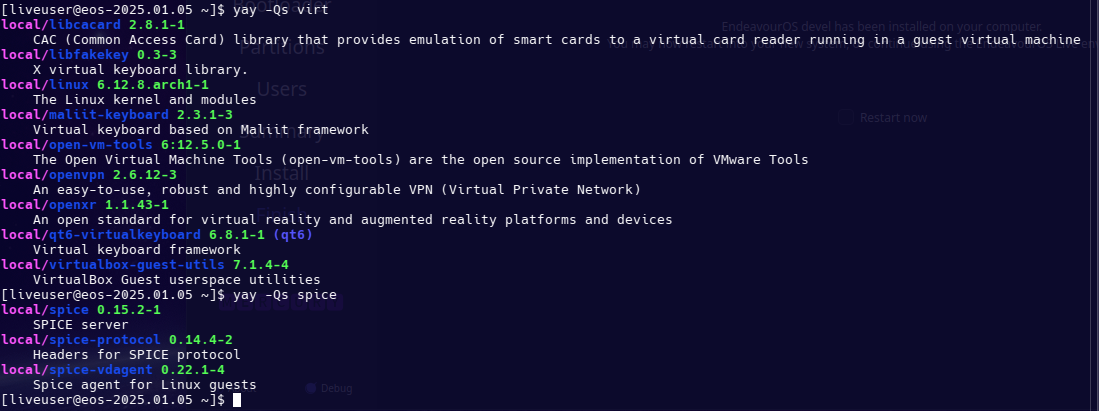

EndeavourOS is adding all needed vm support packages automatically, we support vmware virtualbox and qemu too.
You will see in the vm → yay -Qs spice
yay -Qs virt

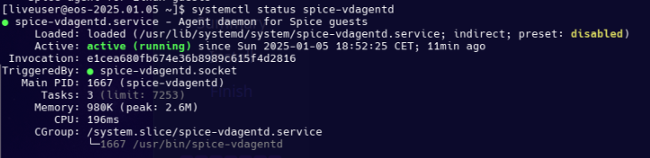

Check if vdagent is running:
systemctl status spice-vdagentd
should get triggered automatically by its socket…
