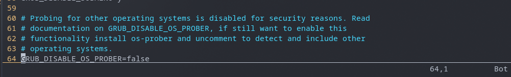

Boot into your EnOS:
Edit /etc/default/grub and set GRUB_DISABLE_OS_PROBER to false.
Then run sudo grub-mkconfig -o /boot/grub/grub.cfg

It was already set to false
Check if os-prober is installed. If not install it and run:
It was already installed. I tried to run sudo grub-mkconfig -o /boot/grub/grub.cfg again and it fixes problem itself.
