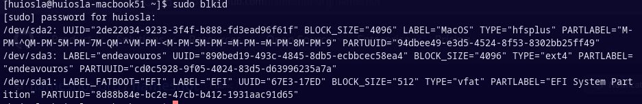

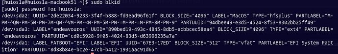

Hey,
Thanks for your reply.

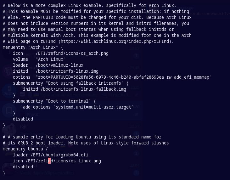

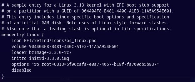

So, I’ve tried looking at the rEFInd page on Arch wiki, and I have actually achieved the desired result, albeit partially, of suppressing all the boot and shutdown system messages: upon the laptop startup, I pressed F2 on the EOS partition, then F2 again, and in the command line (the only one) responsible for the EOS launch I added “quiet splash”, and then the system launched and later shut down without any messages!
There are two issues, though:
  1. While the wiki explains how to make the change permanent, I can’t find this refind.conf life either in the MacOS or EOS partitions, I found only the refind.conf-sample file, which, as I guess, is a sample conf file with lots of options and text. Now, from my understanding, if I want to include anything specified in the refind boot process, I must create a separate refind_linux.conf file in the /efi/EFI/refind directory? If so, there is a sample of such an entry in the aforementioned sample conf file both for the regular Linux and Arch linux specifically, although I don’t really understand where the values/paths are coming from, so perhaps you could help me with this as well? I managed to retrieve my UUID value and I took a screenshot of these entries from the EOS terminal, please find them attached.
  2. Whenever I include the quite splash launch option, while all the messages are suppressed and the system actually boots faster, I get this weird graphical glitch for a second, as if my gpu died or something like that, both at the boot and shut down. It doesn’t affect the system in any way, but it just looks scary, so I’m not sure whether it’s the effect of the quiet splash or whether it can be eliminated somehow as well? I can’t take a screenshot of this, but I can take a photo if needed.
    Thanks for your help so far!
If you are not using an splash screen, then just use quiet and test.
So, after having spent some time browsing the web in search of various solutions, I have managed to save the configuration so that I don’t have to indicate the boot settings every time I launch the laptop.
If there’s anyone else in the same situation as I am, i.e. when there is rEFInd installed on the MacOS partition and it is used as a main bootloader, and you want to get rid of all the boot messages for EOS (I guess any Linux distro will work here), you may set up and save the configuration as follows:
  • as your rEFInd is installed on MacOS, you don’t have the necessary config file named “refind_linux.conf” to save your boot parameters to; to get this file, download the mkrlconf.sh file from rEFInd’s github page: https://github.com/JackieXie168/rEFInd/blob/master/mkrlconf.sh
  • to run this file you need to give it executable rights: chmod +x /path/to/your/script.sh, and then run it with just /path/to/your/script.sh
  • once the script is finished, it will create the refind_linux.conf file which, for me, is stored in /boot/refind_linux.conf
  • you need to edit this conf file with your boot parameters, e.g. quiet splash to suppress the boot messages: sudo nano /boot/refind_linux.conf - this will take you to the conf file through the terminal, where you will simply add [quiet splash] at the end of the 1st line which is responsible for booting with standard options
