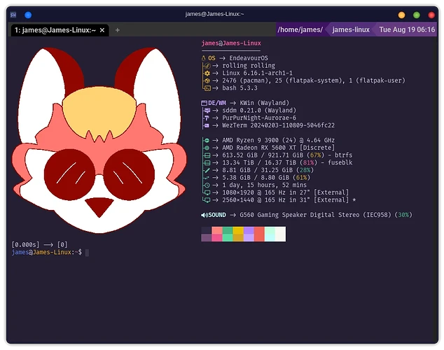

Screenshot_20250818_203809
I’ve recently had a (minor) issue, where the execution time is being displayed after EVERY command,
I can not seem to find anything in my .bashrc or .bash_profile that would be causing it.
I tried a few different Terminal emulators, Konsole, Wezterm, Alacrity, they all display the same behavior so it has to be something system centric, but I can’t figure it out.
This happens no matter what command I execute, what terminal, running Yay for updates, running fastfetch, anything. I’m a bit stumped.

I’m “pretty” sure it’s a display of execution time as, just eyeballing it, it seems to coincide with however long the last command took to execute. I don’t use the terminal a “LOT” but I use it for YAY and a few other things here & there.
This is not breaking my system or impacting functionality in any way, it just looks odd, and started recently, and I was stumped trying to hunt it down.
Even when I first open Terminal, I have it set to always do Fastfetch (because it’s pretty) and it even displays there, just past fastfetch before the first usable prompt
