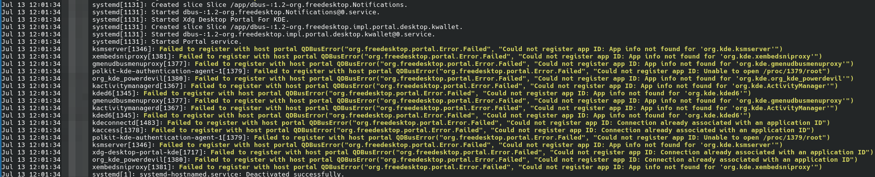

I checked journalctl and this is what I think could be the issue:
After that there’s a long “break” in time and then the desktop/taskbar loads.
Tried googling the “Failed to register with host portal QDBusError” message, but there were a lot of different problems associated with it, none of which seems to be relevant to me.
