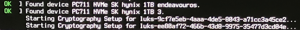

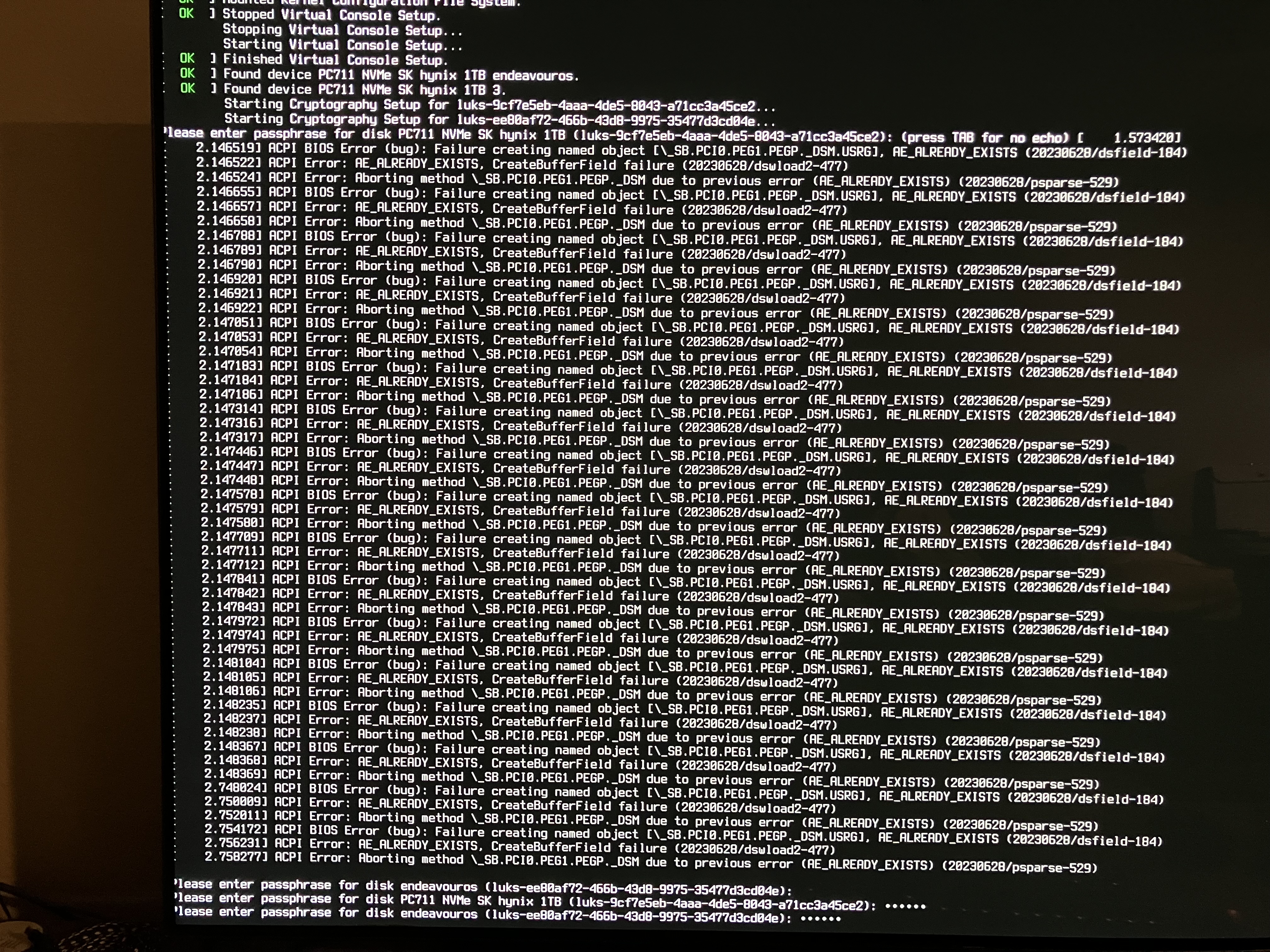

I installed EOS Cinnamon yesterday. I enabled encryption. The initial screen, just as it asks for luks pass, is the image below. After searching the error online I think ive come to the conclusion that it s a windows linux incompatibility issue as this box came with windows. See link below.
Problem is I have to hit enter twice before it will allow me to enter luks pass, and I also have to enter pass twice as you can see in the image below. Is there a way to silence this bug? Is a new install suggested? Or am I struck with this stupid boot sequence? It s interesting to note that Gnom eos, (the last version,) silenced this bug message on screen, but the error was about 95% of the log file content.

Do you have the latest Bios version available?
Yes. I flashed it about 3 weeks ago. The previous eos with errors in logs stated the error then that is was corrected; over and over. Now it is calling it a bug right on the screen.

I see why I have to enter luks pass twice now. It is asking pass for two different drives, or rather, 2 different partitions, because I have only one NVMe drive. Why would it do that?
Probably other partition is encrypted? Swap?
That is not a bug, that is normal if you have more than one LUKS device to unlock. If you don’t want to enter the passphrase more than once you need to set up a keyfile.
https://wiki.archlinux.org/title/Dm-crypt/Encrypting_an_entire_system#Avoiding_having_to_enter_the_passphrase_twice

I should not have chose a swap during install process.
EOS certainly states the word “bug”. I should not have brought up the luks password issue in this thread as it is a seperate issue.
If you used a swap file instead would probably be a solution. :thinking:
