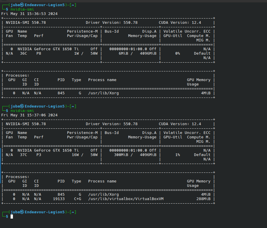

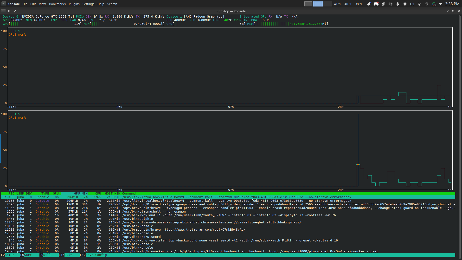

I noticed the Nvidia GPU starts working when using Graphics programs, does that mean I’m using hybrid mode now?
Your laptop may have that option. Have you checked your bios settings? Does it have that option to set hybrid, integrated or dedicated. I’m not sure how you know it’s using the nvidia card when using graphics programs? I’m not familiar with your hardware.
I’m using Lenovo Legion 5, the default mode in the BIOS is hybrid and it is enabled (I should use Nvidia optimus on linux to use it).
I know it using nvidia-smi and nvtop
I see so because it has hybrid mode that is why it is automatically using nvidia when called to. I guess you could try either package then? maybe you have a preference. :thinking:
