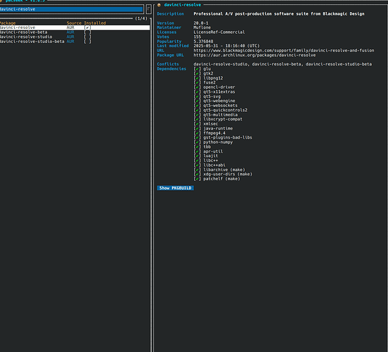

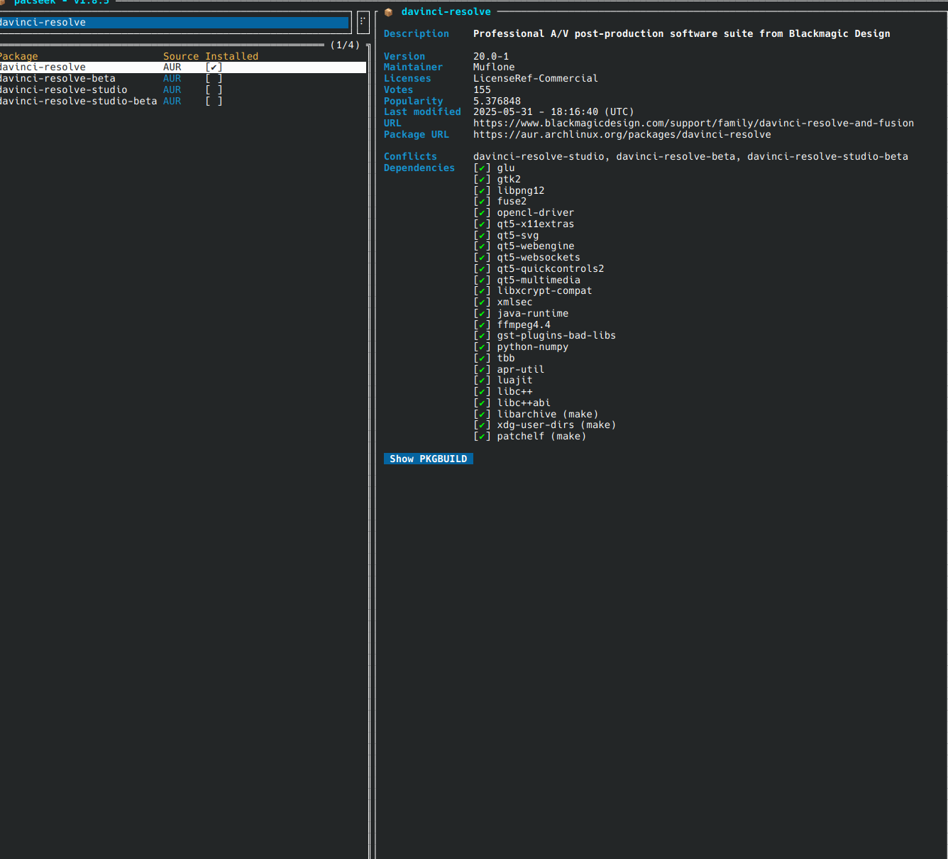

Since davinci cut it’s source zip from the AUR i had to fetch it from their website and mooved it into the temp files of yay for it to install and it’s not working, what should be my first step ?

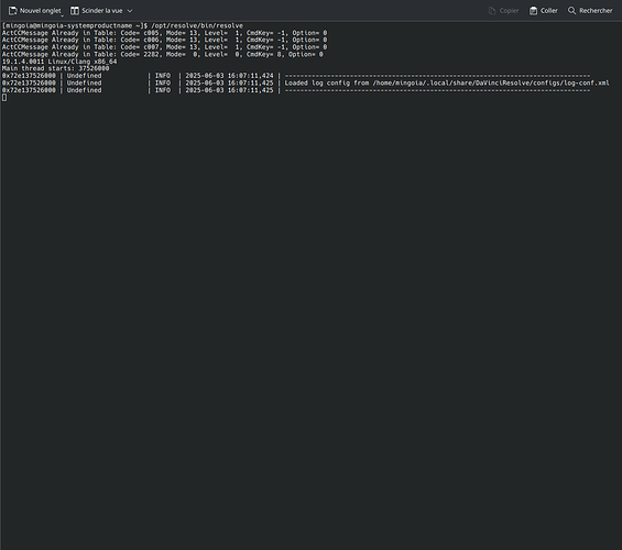

Run DaVinci Resolve via command line, and see if it gives you any useful errors:
/opt/resolve/bin/resolve

This is the output of the terminal when launching davinci from here:
Nothing noticable to me :melting_face:

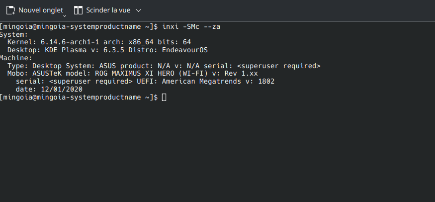

What is your system spec @Raohsty?
inxi -SMc --za

I somehow missed the G on that inxi command, thank you for mentioning your GPU, that was important :sweat_smile:

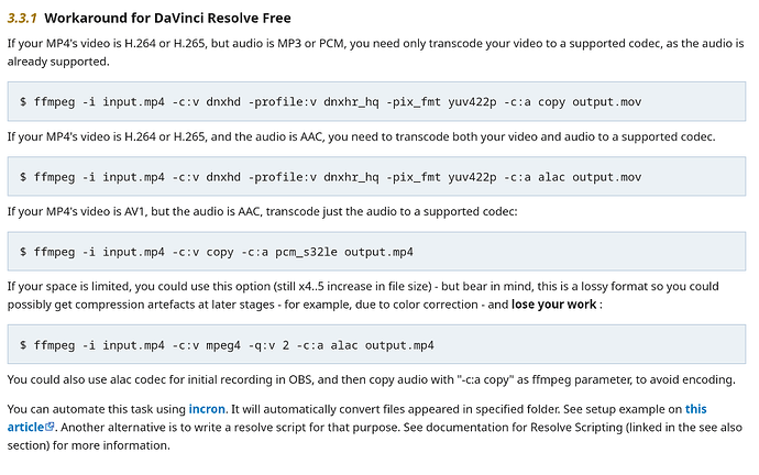

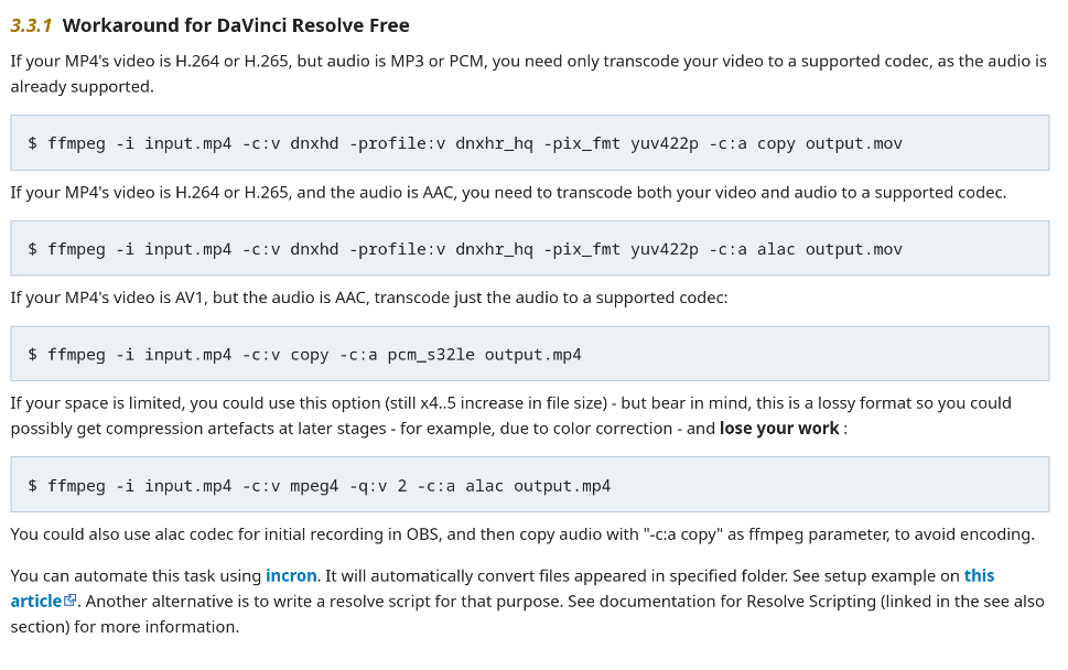

You might like to review some options here:
If budget permits, it’s a compelling reason to invest in the Studio license. It’s a once off purchase that covers you for all major updates, indefinitely as far as I’ve been able to tell.
  • OSX enjoys full H.264 / H.265 and AAC support.
  • Free version under Windows has OS supported 8bit H.264 / H.265 decode and encode. Studio is needed for 10bit or 12bit+ support. AAC is supported.
