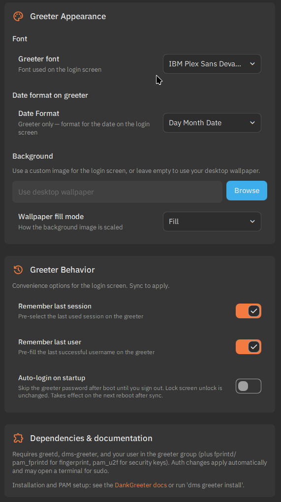

The dank greeter has one benefit, you could sync it’s settings with your DMS theming and the color style and such would match the actual definitions of DMS.
I personally don’t bother that much. To me it’s just the password prompt. There are some options to customize it with a user defined background image as well as the choice of the fonts.
Sure, there might be fancier designs available for DMS. But from a functional aspect, there is no need to use sddm.
I even bet that there would be more control than the exposed configuration settings of DMS when you would like to add specific elements. But that would require to get familiar with qml at least to make the changes and needs to be seperated from the original code to avoid overwriting during updates.
