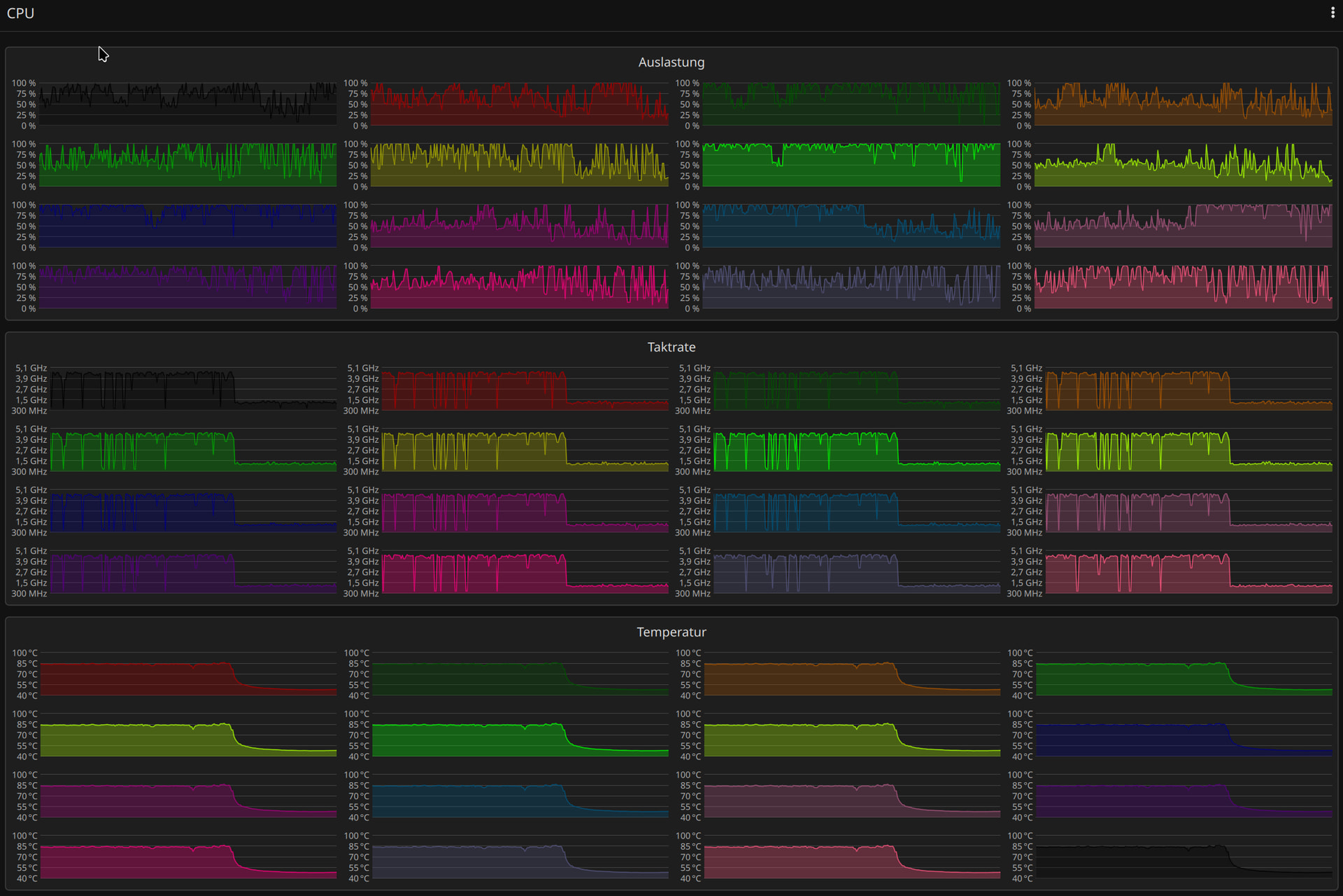

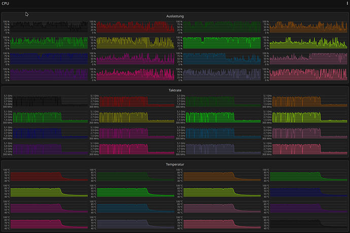

EDIT:
In this screenshot you can see it’s not a problem with temperature, as the CPU sits at ~50°C. I played a game until the sharp drop of the frequency. After that it’s been only building the Kernel with 8 threads.
