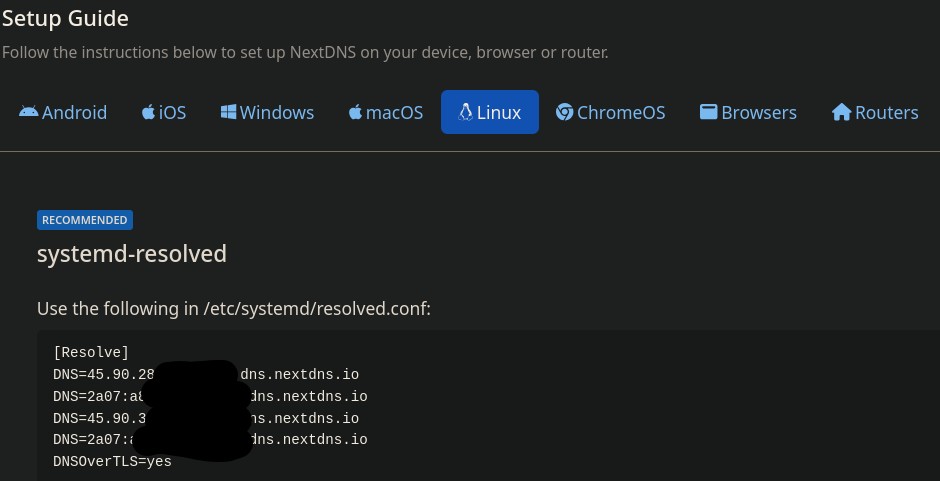

My situation hinges on the use of systemd-resolved.
Which also has a section on setting DNS.
As alluded to above you can do this with something like
/etc/systemd/resolved.conf.d/dns.conf
[Resolve]
DNS=IP1 IP2
Domains=~.

Well, I’ve missed that detail.
But on the other hand, nextdns setup instructions are hard to miss.
Yep, I’ve already seen those. As you probably are aware, “Linux” is an exceptionally large umbrella, lacking specificity, and I’m asking on the EOS XFCE forums, specifically because that is what I’m using, and I wish to do it correctly.
