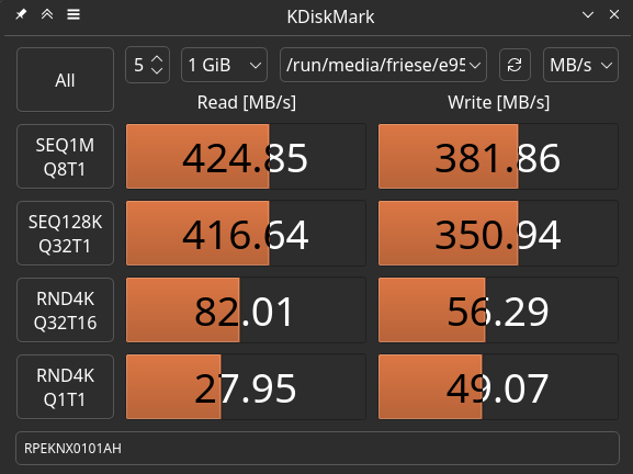

According to this support post, the drive uses an USB 3.2 Gen 2 to PCIe 3.0x2 bridge controller from ASMedia, I’m guessing with one lane for read and another one for write operations. Therefore, the bandwidth limit is essentially 0,97 GByte/s via PCIe (per lane).
Thus, the build in nVME is limited and couldn’t be used to it’s full potential. As it should be able to support PCIe 3.0 with up to 4 lanes.
Thanks for that link. Very useful. I used the command from the last few comments, and was able to get the smart info for my Sandisk drives. It threw me off at first because it showed that it was actually a Western Digital SN560E. I have since discovered Sandisk was part of Western Digital.
On a different note: The external enclosure which I’ve bought for a 256gb Intel Optane nVME uses a different chip, an Realtek RTL9210, but is essentially also limited to 2 PCIe lanes. Will investigate what I’m able to get out of this, but I do expect similar results.
And it’s really not great performance.
In short, with a PCIe 3.0x4 link using an M.2 slot, the sequential read speed could be expected to be 1100 MB/s and 550 MB/s in sequential write speeds. At least that are the numbers which I was able to dig up.
In comparison to my internal WD Black SN770, that’s almost 8x faster in reads and 5x faster in writes.

Just for me, it’s a bit disappointing that the external nVME enclosure essentially only achieves speeds that I would expect from an SATA2 SSD. Therefore I would prefer that route for mass storage. (Mobo only has onje M.2 slot). Which is totally fine as I only purchased that Intel Optane drive for the case of failure, tinkering purposes & distro hopping.

That being said, check the context as I’ve shared a picture of sequential read/writes of my nVME which is housed in an external enclosure. The Sandisk drive from @sempterobit is also nVME in a external enclosure.

The numbers are from an Intel Optane M10 nVME 256GB + 16GB 3-D Vcache, simply thrown into a UGreen external nVME enclosure, which is using a USB to PCIe bridge, the Realtek RTL9210…

I only posted those numbers of my external nVME for him as a comparison. As it seems like, the SanDisk drive is at least able to saturate the bandwidth.
