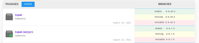

Are you using bspwm or the bspwm-manjaro package?
bspwm-manjaro, its ok, im just trying to learn some of the basics, its fairly new to me exploring linux. I will swap back to endeavour and get it running dw :slight_smile:
OK, that’s interesting because it’s an older package version (plus might have other patches etc.):
Could well mean there’s a bug in bspwm 0.9.10…
If/when you’re back on Arch/EnOS it might be interesting to try that matching version 0.9.7 from https://archive.archlinux.org/packages/b/bspwm/ and see if the issue persists.
