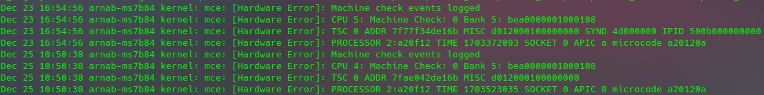

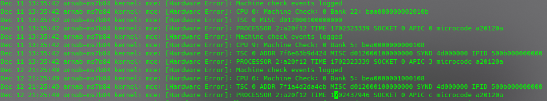

Here is my journalctl log:
Additional logs:

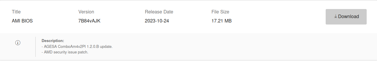

There is also another UEFI Bios update with a new AMD AGESA. I would suggest you update to the latest as the AMD AGESA is extremely important for the Ryzen processors.

My system crashed while on desktop on discord recently. I did the bios update to support my b450m to support the 5000 series but not the most recent update. I will try that and see how that affects things.
Ya try the new UEFI Bios update because the AMD AGESA is all the power related settings for the processor.
@ricklinux
Updated Bios and redid my settings. Will post here if I get issues.

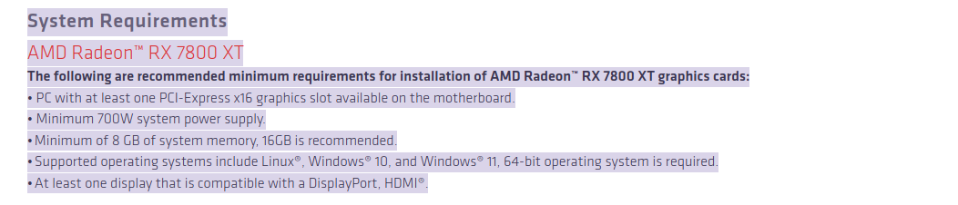

You need a minimum of 700 Watt I would go 750 or 850 Watt! I think the EVGA will be good.
Edit:
I personally don’t make many Bios setting changes related to under volting or over clocking etc. I’m also not a gamer. I just think it’s wise to start from the default Bios settings and then make changes one at a time if you are doing that in order to know that the problem is not being cause by settings that don’t work. I do feel your power supply was under spec required for this card.
Edit: https://www.amd.com/en/products/graphics/amd-radeon-rx-7800-xt
