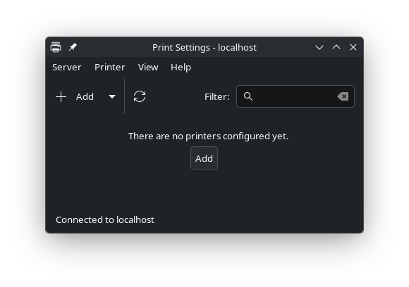

To install just use
yay -S brother-hl1210w and do a clean build using A for all.
Edit: If the package builds and installs then you go into print settings and add the printer.

I did what you suggested with the “A” option. Result…
error: failed to commit transaction (conflicting files)
brother-hl1210w: /opt/brother/Printers/HL1210W/cupswrapper/brcupsconfig4 exists in filesystem
brother-hl1210w: /opt/brother/Printers/HL1210W/cupswrapper/brother-HL1210W-cups-en.ppd exists in filesystem
brother-hl1210w: /opt/brother/Printers/HL1210W/cupswrapper/brother_lpdwrapper_HL1210W exists in filesystem
brother-hl1210w: /usr/share/cups/model/brother-HL1210W-cups-en.ppd exists in filesystem
Errors occurred, no packages were upgraded.
 -> error installing: [/home/ion/.cache/yay/brother-hl1210w/brother-hl1210w-3.0.1-2-x86_64.pkg.tar.zst] - exit status 1
I deleted the four files mentioned and yay completed successfully. But printing with Libre Office Writer doesn’t work with an error I can’t copy referring to a missing “filter”. It only reports that on the first attempt to print. More attempts the error message flashes too fast to read.
Simple question. Should connecting a printer require many hours of wasted time when it connects just fine with MX-25, Debian, and openSUSE?
I don’t think using the 1210w driver is goinf to work to replace the correct 1212w driver, if one exists.
tried open source drivers? brlaser: Select the Brother HL-1210W (or HL-1200 series) entry.
This model is not supported by IPP-everywere driverless modern cups printing sadly., A sits a GDI printer.
from what i can see HL-1211W and HL-1211W is technically the same model only regional differencies.
I am sure you are correct, but there is no driver for HL-1211W.
[ion@ion-desk ~]$ yay -S brother-hl1211w
→ No AUR package found for brother-hl1211w
→ no package found for targets
[ion@ion-desk ~]$
