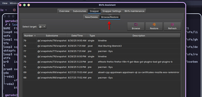

I got some very interesting results. On an EOS system with btrfs-assistant and snapper installed, I booted the Garuda iso and mounted the btrfs nvme on /mnt with subvol=@ and then ran btrfs-assistant-launcher.
It found my snapshots in the snapshot tab, but in the snapper tab there were no configs setup so you could not restore anything.

snapshot tab? Did you select browse/restore tab?
I did select the snapper → Browse/Restore tab.
But there are no configs available.

On a Debian 13 PC, a Debian 13 live ISO boot finds the snapshots on the snapshots tab, but on the snapper tab it finds nothing due to not locating any configs. Since the Debian 13 live ISO doesn’t have btrfs-assistant, I had to apt install it first.
The is the same behavior I saw with a EOS PC booting the Garuda ISO. It couldn’t find any configs either. However, I can’t duplicate that result since I can’t install any AUR packages right now.

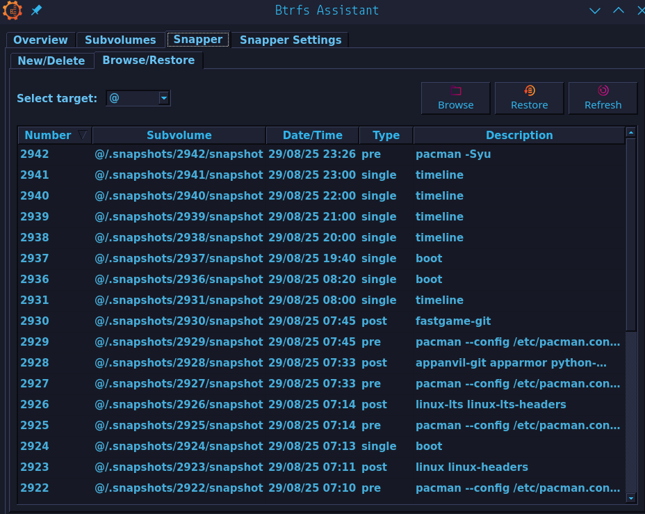

My properly functioning (EnOS host, Garuda live iso)
garuda-mokka-linux-zen-250826.iso pre-installed is 2.2-1 according to pacman.
But sudo btrfs-assistant –-version tells 2.1.1
