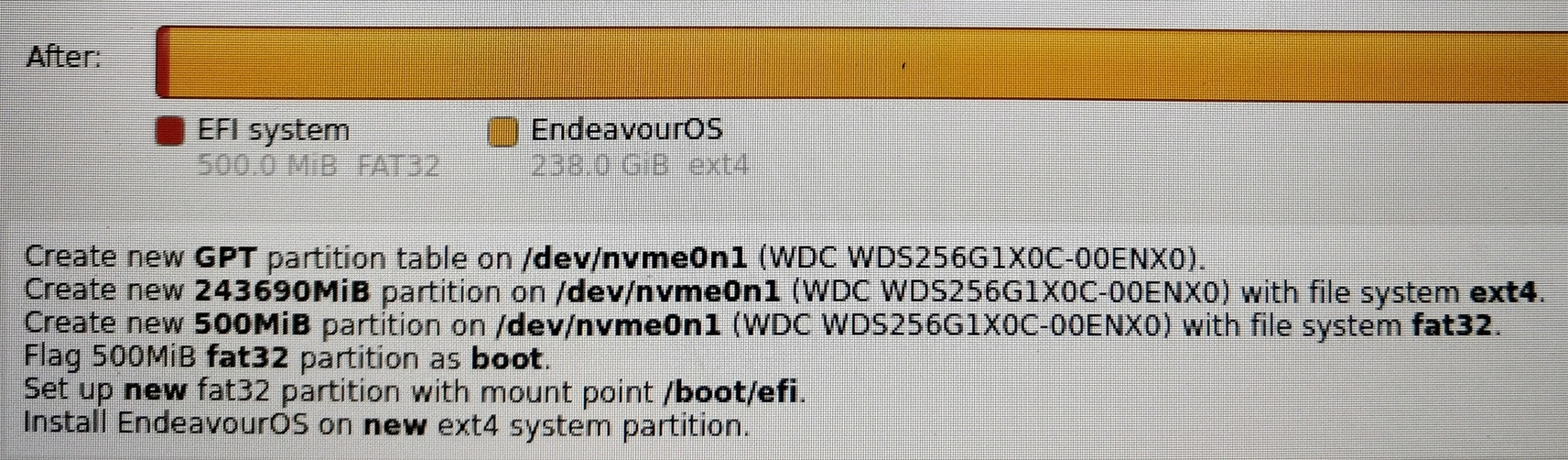

IMG_20190819_220445
This are the partition. I tried several times and one of the trial it worked but it won’t boot into the os and it didn’t recognize my os drive.

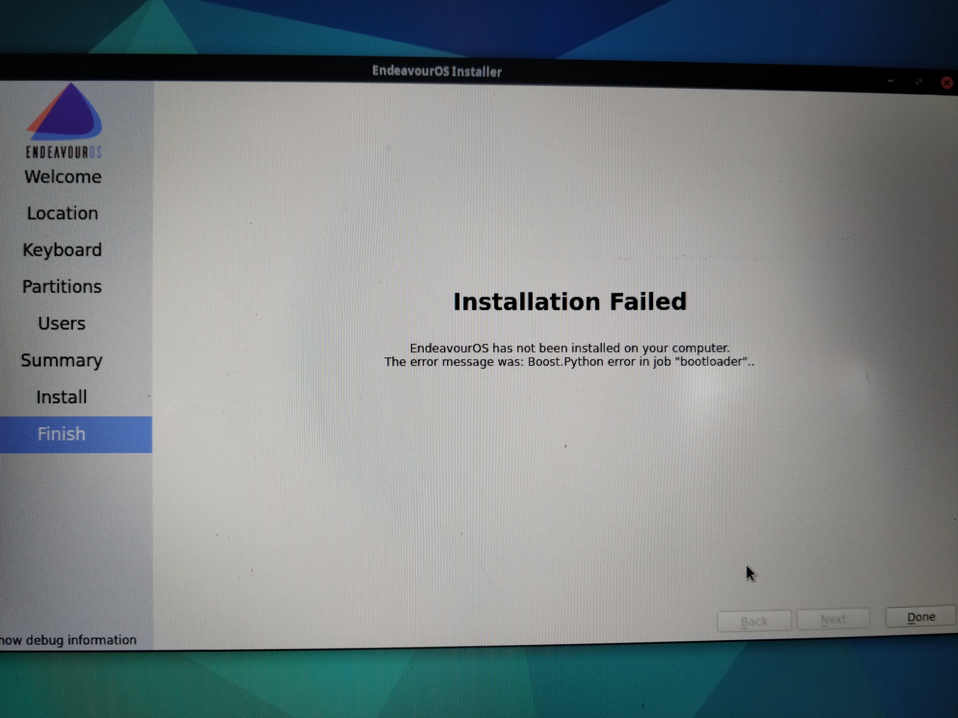

IMG_20190819_220101
This is the mentioned problem. Installation failed and when reboot the primary drive is not recognized and boots into bios…

Hello @noir12 Would it be possible for you to send the logs that @joekamprad has asked for? We really want to help you figure out what caused this install failure and this information is very helpful. I’m sorry that this issue has happened but we want to help you solve it.
Thanks.

@ricklinux @Computer issue from help searching user is not related to wrong partition scheme, he was creating it the standard way for EFI systems.
an ESP fat32 partition with 500mb mounted under /boot/efi the same that calamares would create automatically.

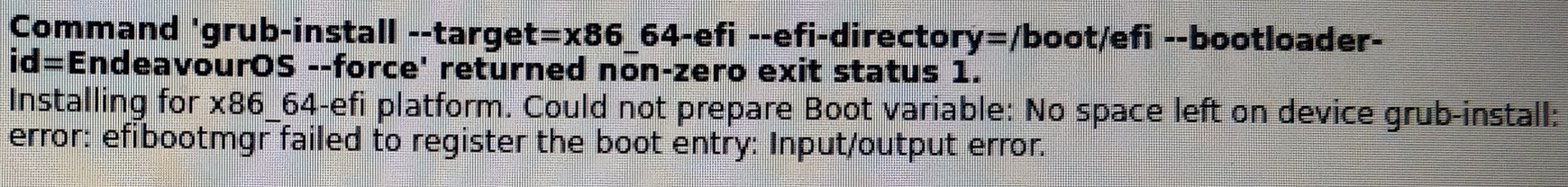

it is more likely real issue is linked to what is shown inside the error:
Bildschirmfoto%20vom%202019-08-21%2007-34-18
And @noir12 should provide the logs, and try to erase the drive with gparted prior installation.
