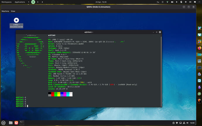

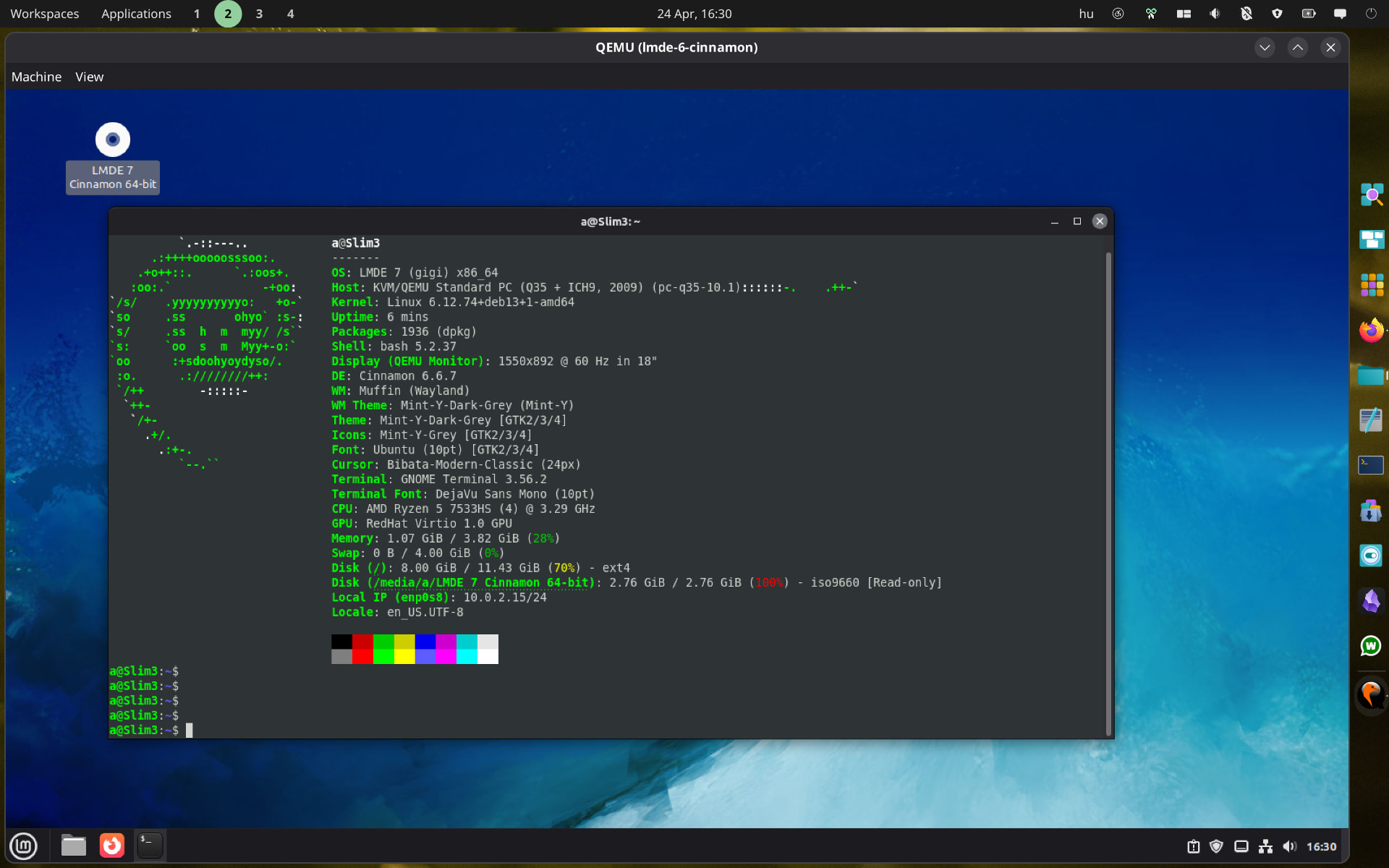

i know wayland session was starting properly before on my tests in VMs too.. now its failing the same all over the place, and it had even keymap set from what i remember?
I played with cin in vms for a while tried downgrading muffin / mesa and using git versions with no change on the issue. No checking on real hardware too..

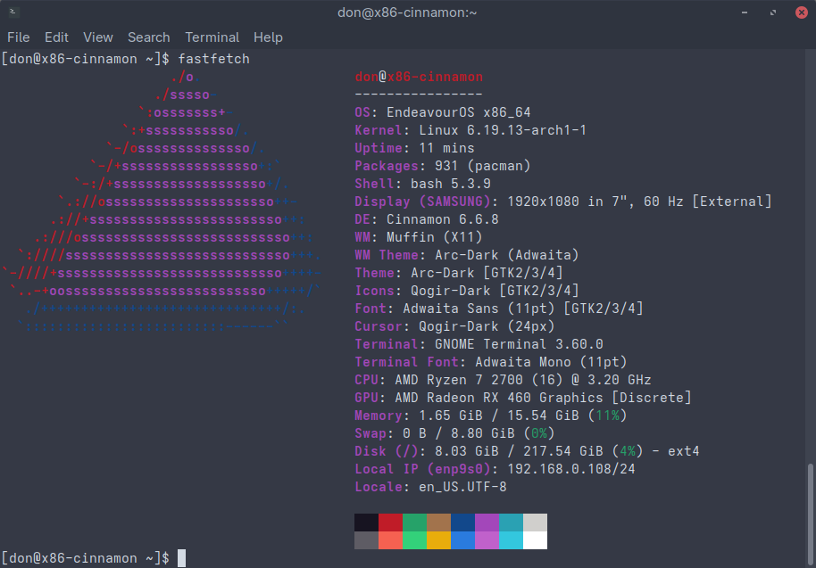

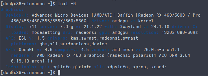

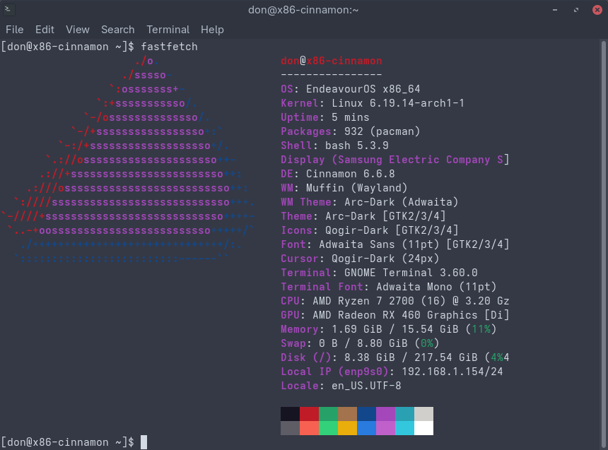

After today’s updates, Cinnamon on Wayland now works on both RPi 5 ARM and on x86_64.
