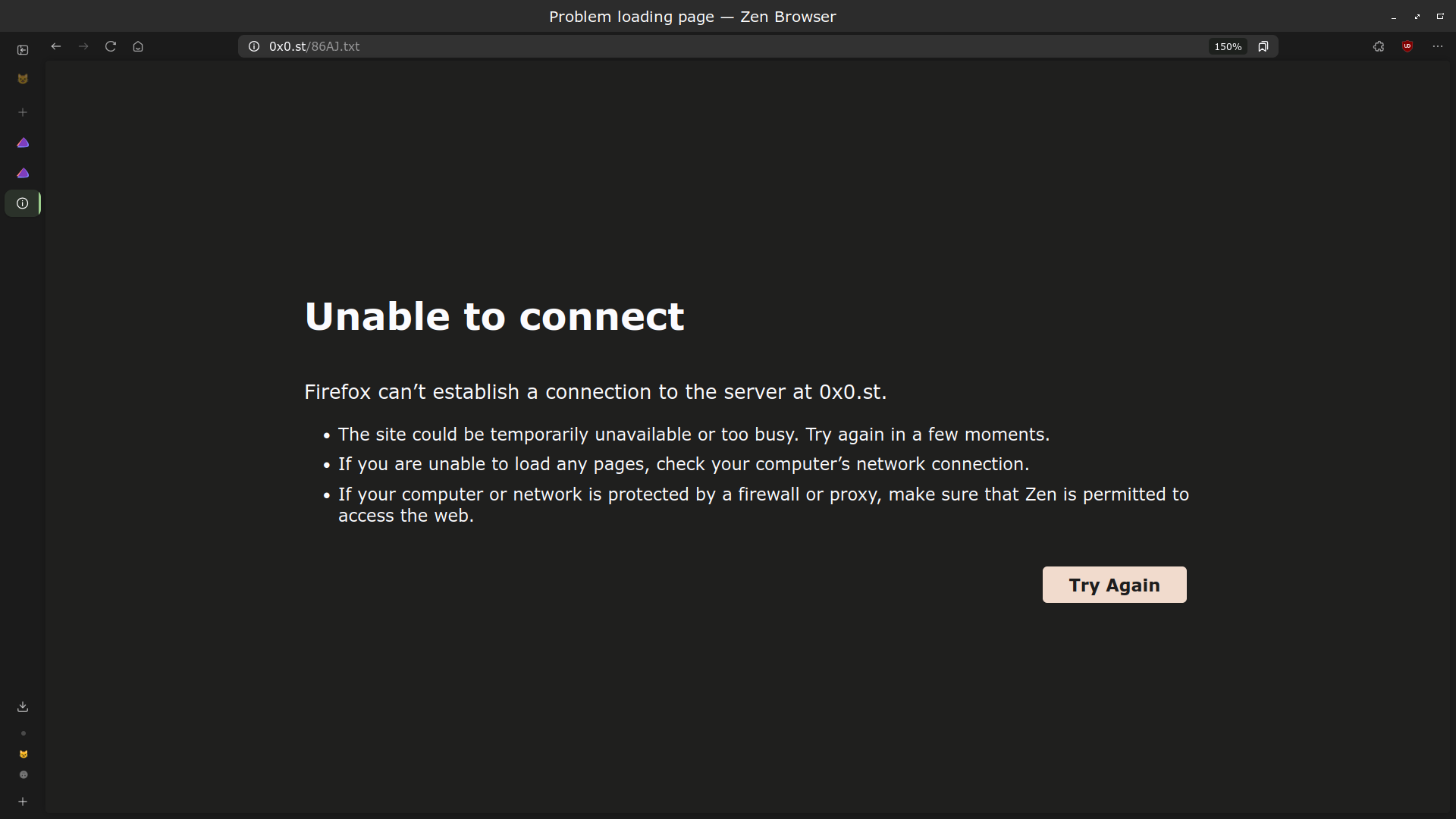

hmmm this is what i get when i try to get the logs. Looks like I’ll have to try later.
