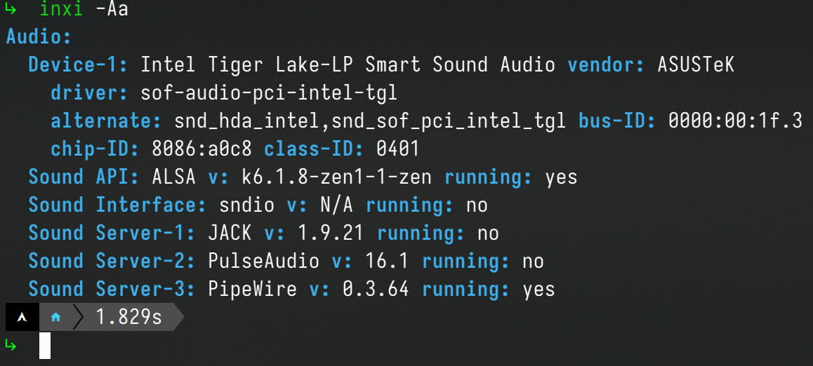

I have the same hardware on one of my machines
I would recommend you to try issuing this command to reinstall kernel, firmware and pipewire stuff first. There are issues with wireplumber so I also recommend pipewire-media-session
yay -S linux linux-headers sof-firmware pipewire pipewire-pulse pipewire-media-session
Then reboot and make sure you are booting in the correct kernel (current version of arch kernel is 6.1.8.arch1-1)
Then run alsamixer press F6 and select the first sof card from the list. Now make sure the auto-mute mode is disabled
Also make sure you are not running two sound servers at the same time, and that you have rtkit and/or realtime-privileges packages installed so pipewire can work with realtime priority.
