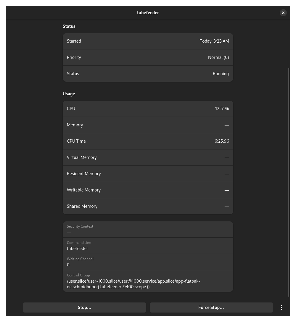

while using Pipeline to watch a video, cpu usage got high, temperature started reached 100 °C and fans started spinning.
I tried the following:
  • quitting using ctrl+q just shut down the gui but it still ran in the background and resources were still consumed
  • using gnome’s system monitor’s (terminate/stop/force stop) didn’t work either and the process kept running
  • sudo kill -9 PID didn’t work either
  • I logged out of the session and I could still hear the fans still spinning and cpu usage was high, the process didn’t stop either
  • I tried shutting down the pc but it got stuck with systemd trying to terminate the process so I had to press power button for 10 seconds to force shutdown. this seems to be the only way I can stop the running process
here’s how the process looked like before force shutting down the pc:

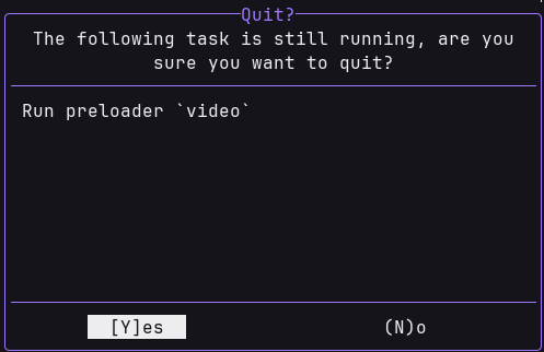

something similar happened recently while using yazi. while accessing ~/Videos, fans started spinning even after quitting yazi, ffmpeg was still running with a high cpu usage (it was initiated by yazi) and the above methods didn’t work either.
pipeline was installed as a flatpak while yazi was installed through pacman and both faced the same issue. so I guess the problem isn’t specific to a certain program.

Hello everyone, thank you for the very detailed responses! I tested the mentioned solutions but they kinda didn’t exactly work.
here’s what exactly happened:
  1. I enabled SysRq key, tried it first while everything was normal and it seemed to work.
  2. I then proceeded to launch yazi and I encountered the same problem. Here’s what it showed me when I tried to quit it anyway
  3. I tried SysRq REISUB sequence to terminate ffmpeg process and pc rebooted but I saw an fsck check while rebooting so I assumed it didn’t terminate the process gracefully (I generally get an fsck check when I force a shutdown).
  4. After the reboot yazi worked with no problems, the video preloader didn’t get stuck at all.
  5. I rebooted the pc just to make sure but the problem appeared again, I tried pkill ffmpeg as @vazicebon suggested but it didn’t work.
  6. I tried SysRQ+R+E+I and it would get me to GDM login screen but I can’t log in and the fans are still spinning (so the process still didn’t get terminated)
  7. I tried SysRq REISUB in order and it rebooted but still gave me an fsck check again during boot.

I was referring to the stuck process caused by yazi this time which was ffmpeg. Sadly pkill didn’t terminate ffmpeg nor tubefeeder :sweat_smile:
