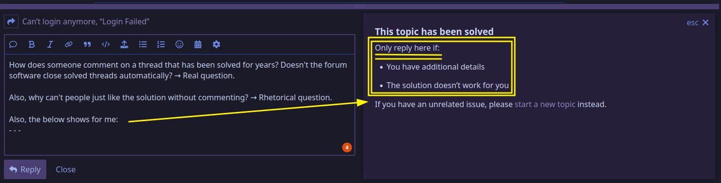

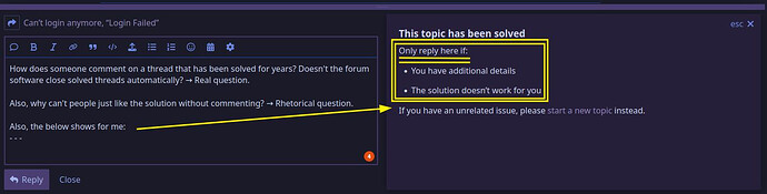

How does someone comment on a thread that has been solved for years? Doesn’t the forum software close solved threads automatically? → Real question.
Also, why can’t people just like the solution without commenting? → Rhetorical question.
Also, the below shows for me:
