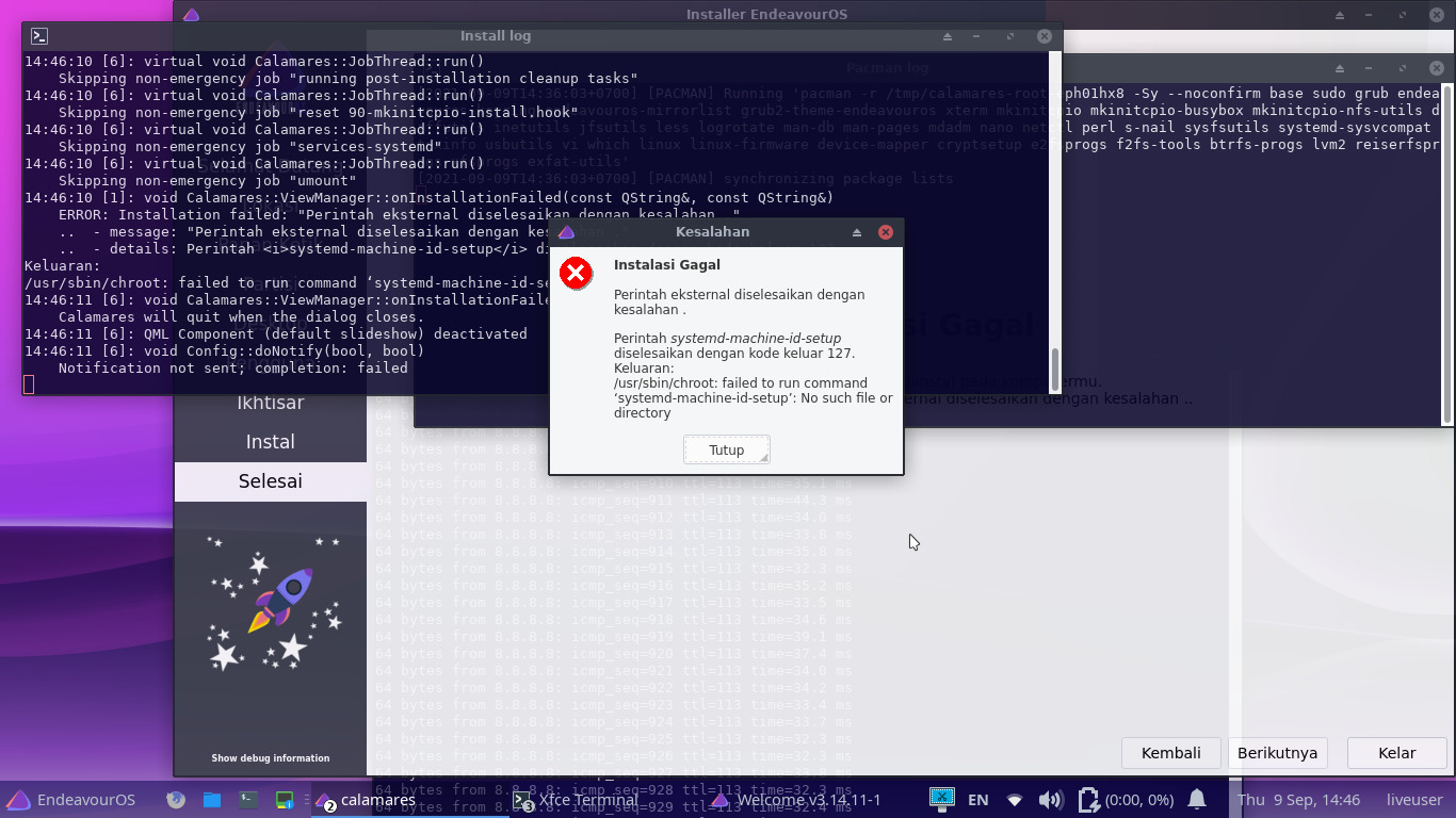

i want install arch based distro with LXQt DE and i found endeavouros but when i online install i always get an error exit code 127 and installation failed and not complete…
error

Problem seems to be with mirrors that are failing.
You could try updating the mirrorlist with terminal command reflector-simple.

yes failed to fetch base packages “Errors occurred, no packages were upgraded.”
    Got locale language "id_ID.UTF-8"
    ..  extracted country "Indonesia" :: ("id", "ID")
You should run update mirrors before start install… and make sure to add some extra countries nearby, and HTTP protocol.
With this install should run fine for you!
