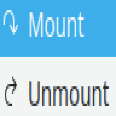

PS : I’ve also tried to add any “iso mounter” on Dolphin, but nothing works…
On Manjaro, I was able to right click and select “Mount” on an Iso, And that’s what I try to get on my fresh EOS setup :wink:

And Iso Mounter/Unmounter makes nothing.
